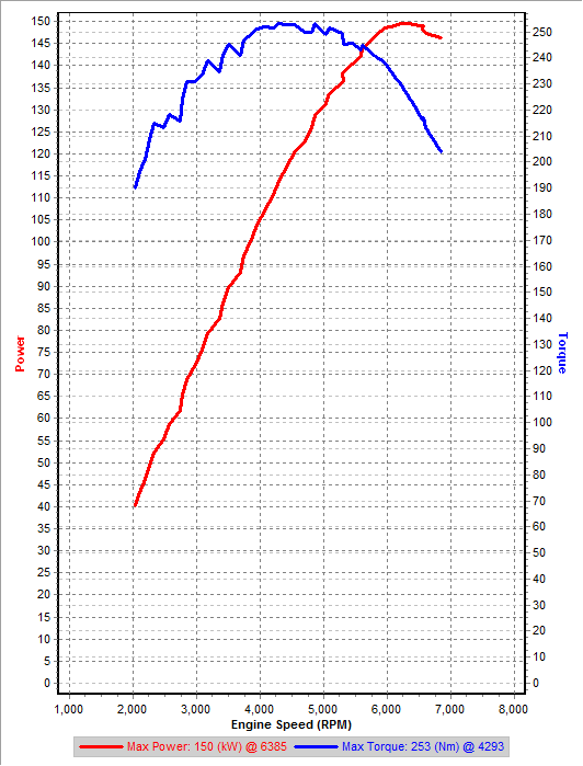

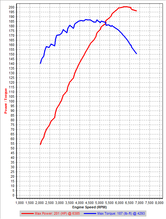

Stock 3rd gear Dyno IAT=1C
Posted: Sat Dec 04, 2010 10:22 pm
Stock 3rd Gear Dyno IAT=1C.png (15.83 KiB) Viewed 13037 times
Stock 3rd Gear Dyno IAT=1C kw.png (17.68 KiB) Viewed 13037 times

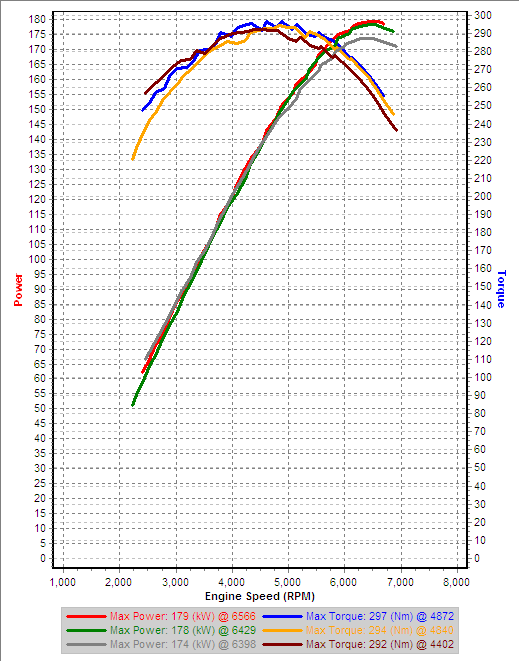

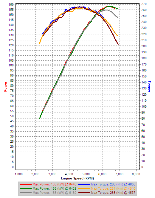

v8 3rd Gear Speed Dyno IAT=6_8_9.5C Comparisons.png (21.39 KiB) Viewed 12909 times
v8 3rd Gear RPM Dyno IAT=6_8_9.5C Comparisons.png (22.41 KiB) Viewed 12909 times

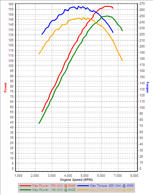

v8 vs v7 3rd Gear Speed Dyno.png (20.5 KiB) Viewed 12940 times
v8 has Exhaust and K&N Filter mods with ignition tuning compare to v7.
Re: Ingmar - 2006 EDM Subaru Legacy 3R 6MT - Tuning
Posted: Sun Mar 06, 2011 8:05 am
by I Wish
Wow. The exhaust really worked.
Well done.

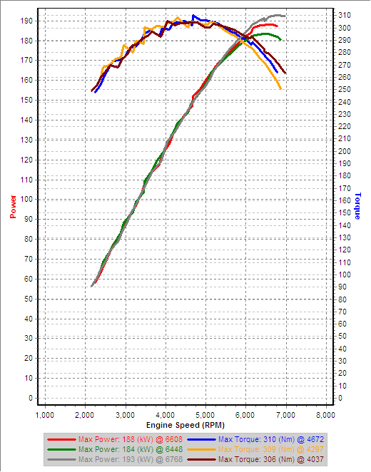

v10 3rd Gear Speed Dyno IAT=6-5-4C.png (22.21 KiB) Viewed 12894 times
v10 3rd Gear RPM Dyno IAT=6-5-4C.png (20.92 KiB) Viewed 12894 times
