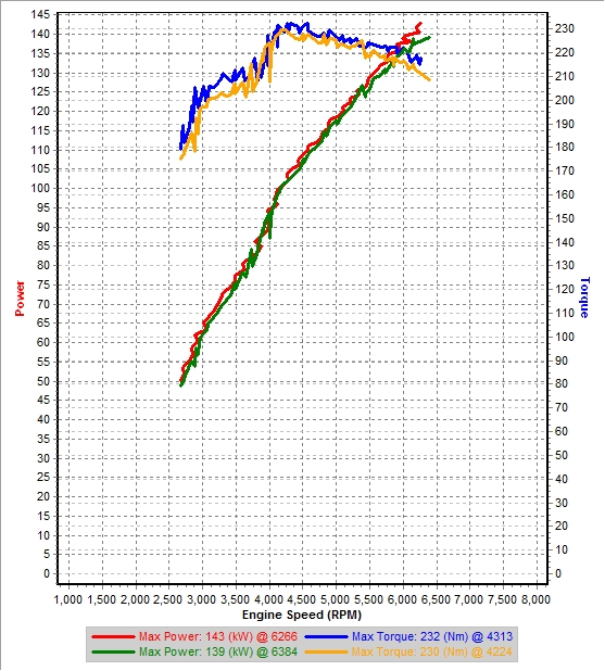

Stock 3rd gear Dyno IAT=16.1C vs IAT=20.5C
Posted: Fri Jun 25, 2010 10:04 pm
Stock 3rd gear Dyno IAT=16.1C vs IAT=20.5C.jpg (304.83 KiB) Viewed 22017 times

How come this dyno is so "ziggy" and not smooth as compared to others?
Re: BrisLiberty - 2008 ADM Subaru Liberty 3R 5EAT - Tuning
Posted: Sat Jun 26, 2010 5:18 pm
Maybe because of the road, but from the logs, the pickup look like that.the car was not pulling continuously. V0 rom was release and I will look at this behaviour.

With regards to the stock tune graphs that have been posted, some of the jaggedness will be due to my choice of bumpy back road for the log. Speed ended up close to 160kph, so not able to do this sort of test on the freeway!
