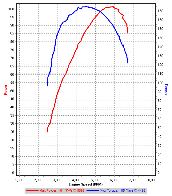

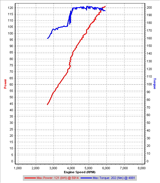

Stock Dyno Performance
Posted: Thu Feb 18, 2010 8:15 am
'es IAT=56-38C.png (16.41 KiB) Viewed 13592 times
StocK 2nd Dyno'es IAT=56-38C
'es IAT=50-29C.png (17.04 KiB) Viewed 13592 times
Stock 3rd Dyno'es IAT=50-29C
Re: 2005 ADM Subaru Liberty 3.0R 5EAT - Tuning
Posted: Fri Feb 19, 2010 12:07 am
by BlackFlatSix05
WTF is going on in those graphs ?
Posted: Fri Feb 19, 2010 3:36 am
BlackFlatSix05 wrote:WTF is going on in those graphs ?
If you think about it, the 3rd gear graphs will look like that. Eco to normal mode, including closed-loop to open-loop and maybe and I feel its more the torque convertor locking up after 4000rpm

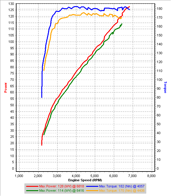

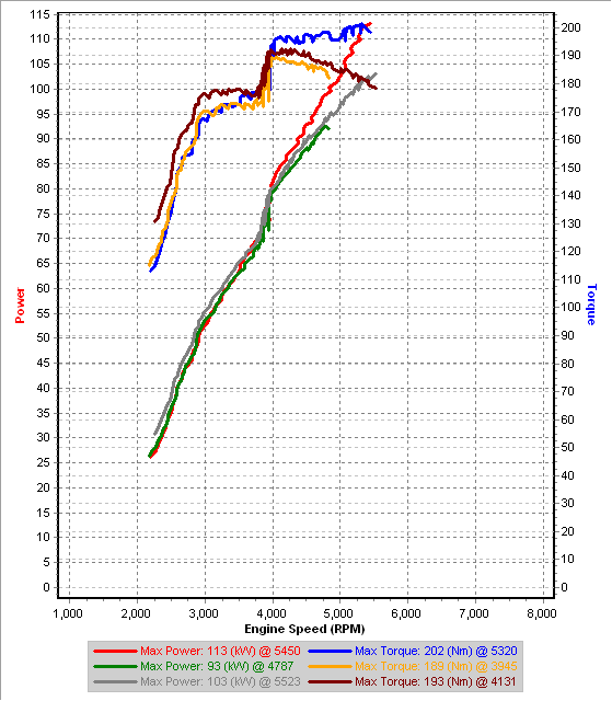

v1 Stats
Posted: Mon Feb 22, 2010 6:06 pm
v1 2nd Gear Dyno IAT=42-38C.png (14.44 KiB) Viewed 13565 times
v1 3rd Gear Dyno IAT=39-31C.png (13.67 KiB) Viewed 13565 times
