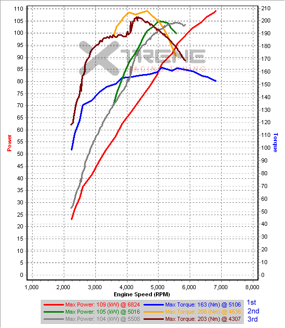

Posted: Tue Feb 02, 2010 10:16 am
Stock Dyno - 1st to 3rd gear.png (22.97 KiB) Viewed 11113 times

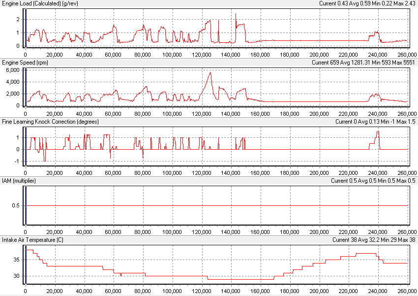

Stock performance log 1.png (21.28 KiB) Viewed 11118 times
Stock performance log.png (19.87 KiB) Viewed 11120 times

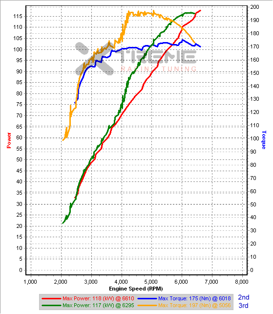

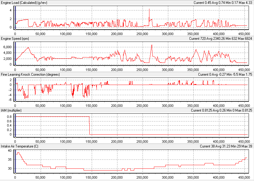

v0 Stats
Posted: Wed Feb 10, 2010 7:48 pm
v0 2nd & 3rd Gear Dyno IAT=30-38C.png (21.34 KiB) Viewed 11113 times

from Trojan
to socob.bb@gmail.com
date Wed, Feb 10, 2010 at 10:18 AM
subject Re: V0
mailed-by gmail.com
signed-by gmail.com,googlemail.com
Much better throttle response to the extent it catches us off guard when we are reversing out of our driveway.
But I also noted increase fuel usage - probably us accelerating faster and thus using more fuel.
