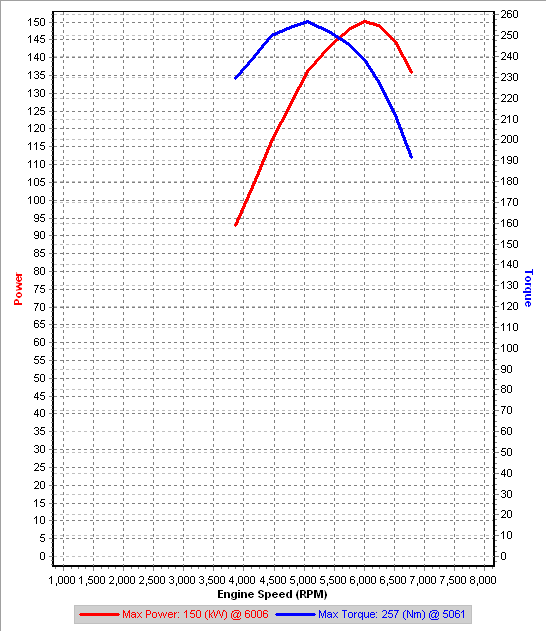

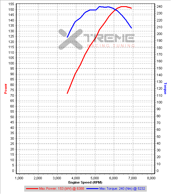

Posted: Mon Jan 18, 2010 1:26 am
[youtube]http://www.youtube.com/watch?v=kIIBDUyPbTE[/youtube]
Stock Performance.png (25.91 KiB) Viewed 15996 times
Stock 2nd Gear Dyno IAT=23C.png (13.37 KiB) Viewed 16029 times
Stock 3rd Gear Dyno IAT=25C.png (14.1 KiB) Viewed 16029 times

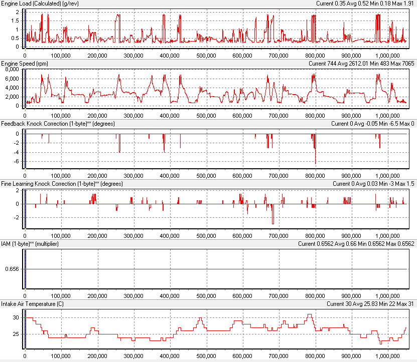

06 Blitzen v2 Stats
Posted: Thu Jan 21, 2010 12:11 am
v2 Stats.png (21.2 KiB) Viewed 16009 times

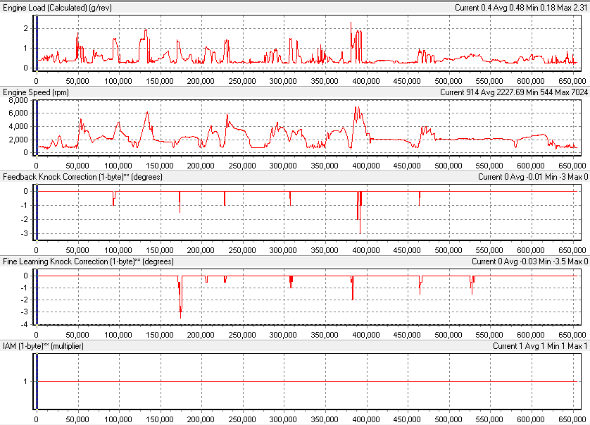

06 blitzen wrote: Its feeling nice.
feels quicker with acceleration, pulls good, and weirdly sounds good?!l

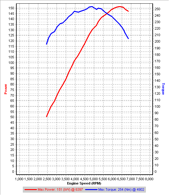

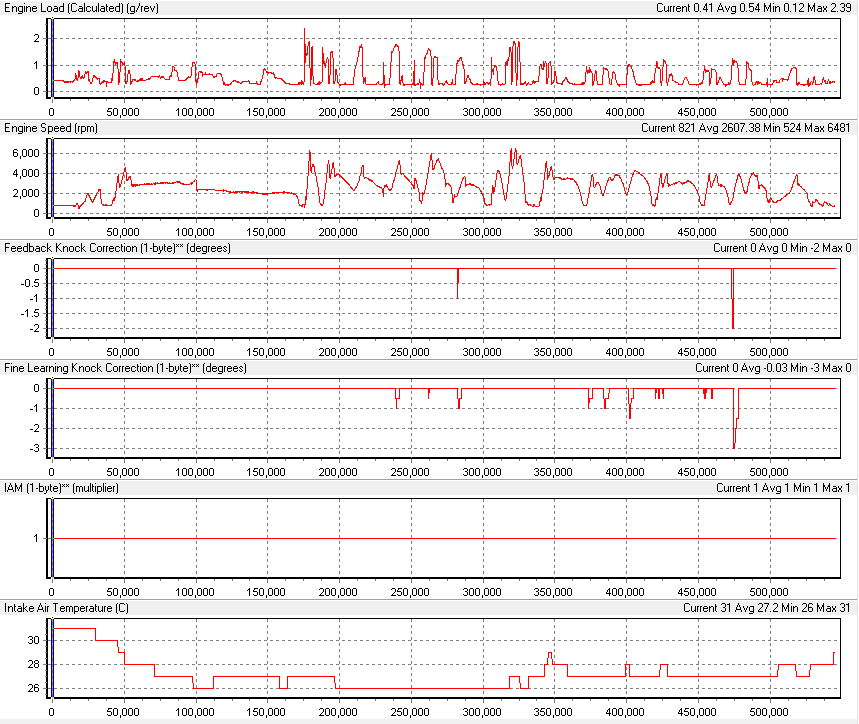

v5 Performance Stats
Posted: Tue Jan 26, 2010 1:52 pm
v5 Performance Stats.png (23.41 KiB) Viewed 15996 times

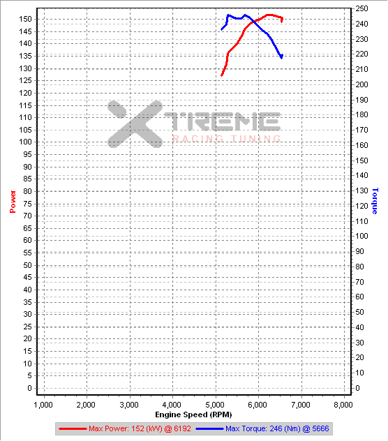

v6 2nd & 3rd gear Dyno'es @ IAT=32C
Posted: Tue Feb 02, 2010 8:40 am
v6 2nd Gear Dyno Partial IAT=32C.png (17.93 KiB) Viewed 15978 times
v6 3rd Gear Dyno Partial IAT=32C.png (17.08 KiB) Viewed 15978 times

edward has been great. very patient replies very quickly and has the updates emailed back to you almost as quickly as you get him the log
Re: 06 blitzen - 2006 ADM Subaru Liberty 3R 6MT - Tuning
Posted: Sun Feb 07, 2010 11:09 am
06 blitzen wrote:edward has been great. very patient replies very quickly and has the updates emailed back to you almost as quickly as you get him the log
Thank you!!!! So where is my log sir???? :) We are almost finish.
On another note, how do you like the final DBW? Do you need it tuned further?
I am now offering customers options to have their DBW tune to their our needs. in your case since you do not have SI-Drive, we can tune this one setting to your liken. Hit me up on an email what your needs are and I can communicate the pricing and time needed.
