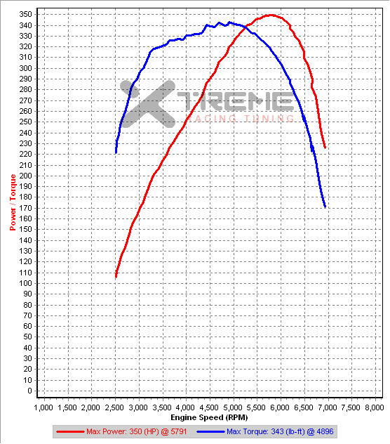

V2-4 Road Dyno Stats
The car has a very quiet Turbo-back Exhaust system. It is cause quite a bit of back pressure. I advised the customer to change to an APS 3.5", which is still quiet.
3rd Gear Road Dyno, IAT=43.3C, pretty hot

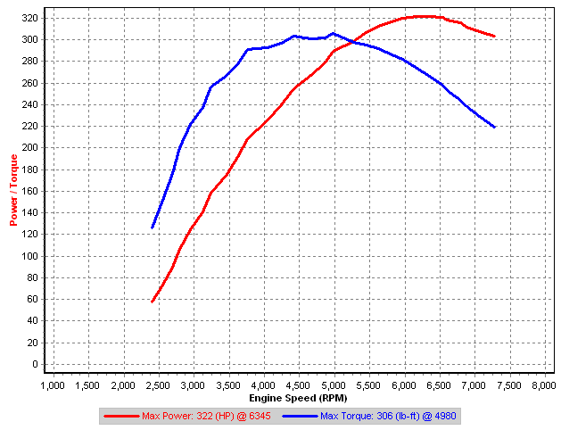

4th Gear Road Dyno, IAT=35C, it would be nice to see a night run

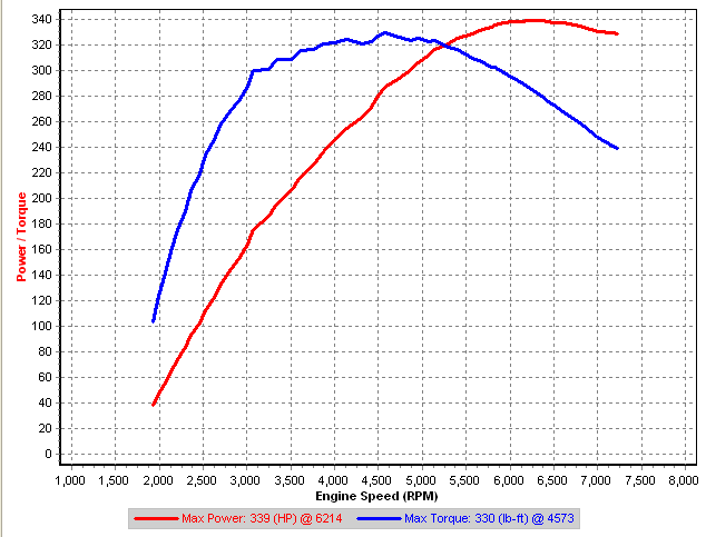

Drag pulls show power on a Toluene mix.
1,2,3rd Gear Drag v2R-2 Dyno combine.png (17.59 KiB) Viewed 35503 times

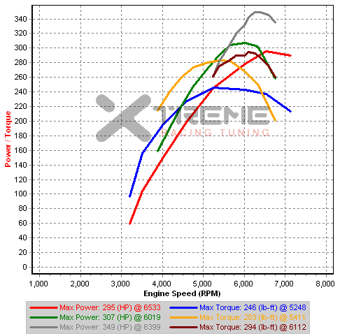

v2-9n of Pump Gas
Posted: Fri Jan 22, 2010 1:23 pm
v2-9n 4th Gear Dyno Partial IAT=30C.png (18.46 KiB) Viewed 35319 times
