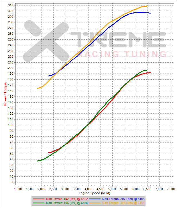

Old boost vs New Boost
I believe the car have a leak in the intake system and maybe around the injectors. Customer been notified
SC Boost Comparison - 3rd Gear Dyno SAE.png (56.24 KiB) Viewed 28407 times

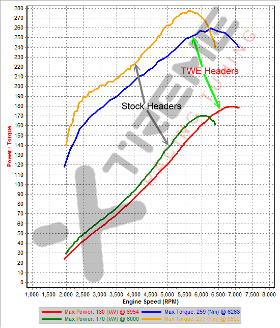

I believe this car needs the TWE mid to race cams to bring to live the TWE Headers.
Either the TWE Stage 2 or Stage 3 would be great, but I would settle for the Stage 2.
http://techworkseng.com/Products/Subaru_Engine_Cams.htm
Stock Headers vs TWE Headers
v10 vs v4 - TWE vs Stock Headers - 3rd Gear Dyno SAE.png (59.42 KiB) Viewed 28360 times
