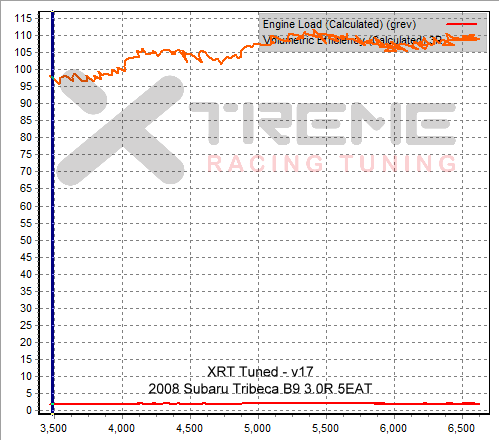

XRT v17 Engine VE.png (18.92 KiB) Viewed 6849 times

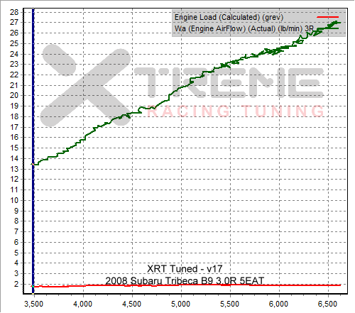

XRT v17 Engine Flow.png (19.04 KiB) Viewed 6849 times

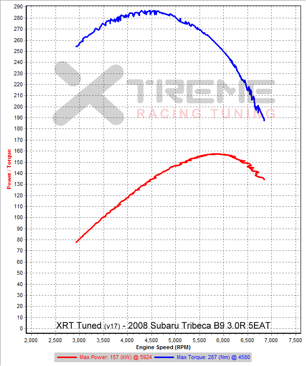

v17 2nd Gear Dyno SAE.png (32.53 KiB) Viewed 6850 times
