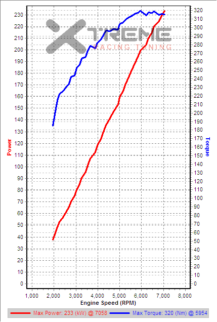

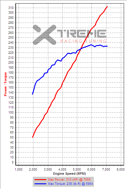

AVCS tuning at high RPM and minimising pinging around 6000 +_ 2000rpm. Spark plugs need changing.
Max boost is 5.14psi from 6000+
scv3 3rd Gear Dyno IAT=75C.png (26.62 KiB) Viewed 19516 times
