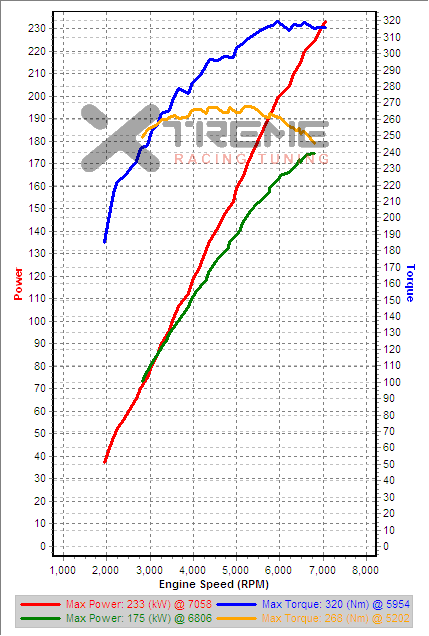

AVCS tuning at high RPM and minimising pinging around 6000 +_ 2000rpm. Spark plugs need changing.
Max boost is 5.14psi from 6000+
scv3 3rd Gear Dyno IAT=75C.png (26.62 KiB) Viewed 19586 times
scv3 3rd Gear Dyno IAT=75C whp.png (22.52 KiB) Viewed 19586 times

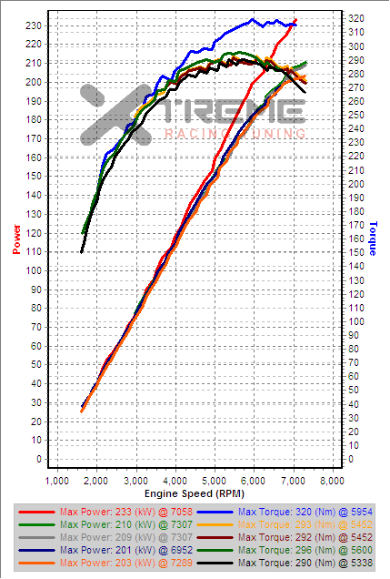

SCv3 vs SCv1
Highest figure is SCv3
scv3 vs v27 3rd Gear Dyno comparison.png (31.53 KiB) Viewed 19586 times
scv3 vs all scv1 - 3rd Gear Dynos.png (42.1 KiB) Viewed 19586 times

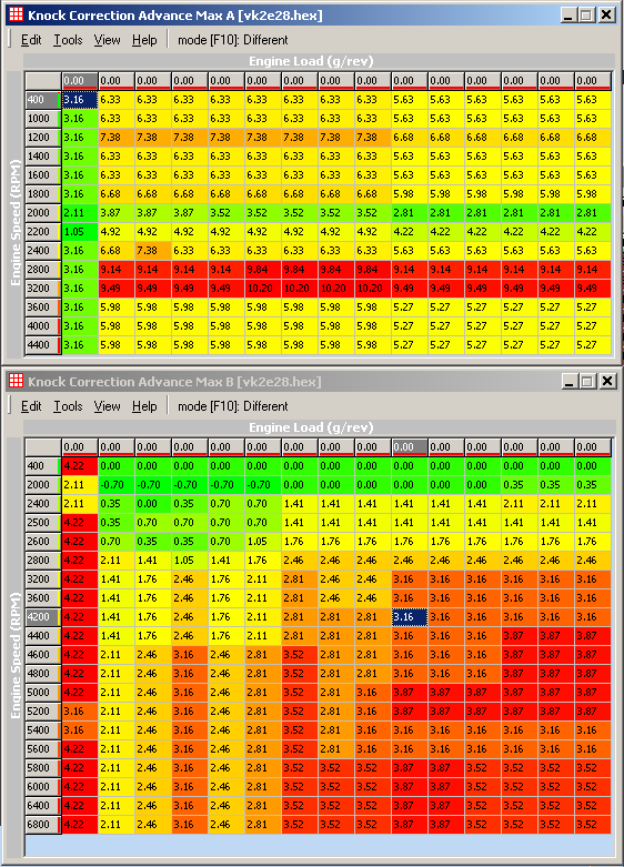

Final Headers Tuning picture
v20 to final v28
+ve shows ign added when compare to v20. Stats are from v28 rom.
Headers Tuning.png (26.2 KiB) Viewed 19371 times
