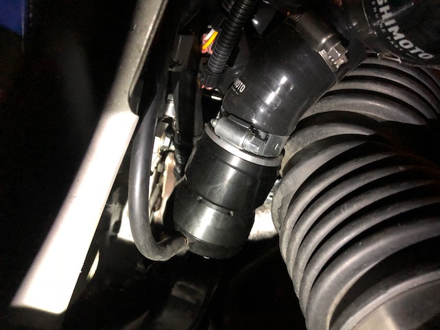

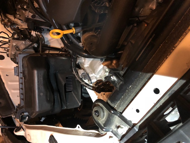

turbo drain sump vent can be teed into Mishimoto crank case vent hose (supplied with intercooler kit). right behind the AC compressor. you can see it in one of the previous photos.

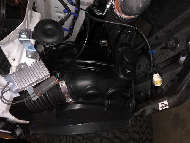

I bought a OEM 15+WRX air box and pipe but the mass airflow sensor did not fit in the WRX box, so I flipped the XV air box up side down and attached it to the WRX turbo inlet pipe, it works but I plan on fabing a custom intake in the future. They sell aluminum mass air flow bungs on ebay, XV is same as STI just not WRX

I used a GFB recirculating valve for a 15+ WRX and it installed as it would on the WRX. I ran the vacuum hose to the plugged port on the intake manifold

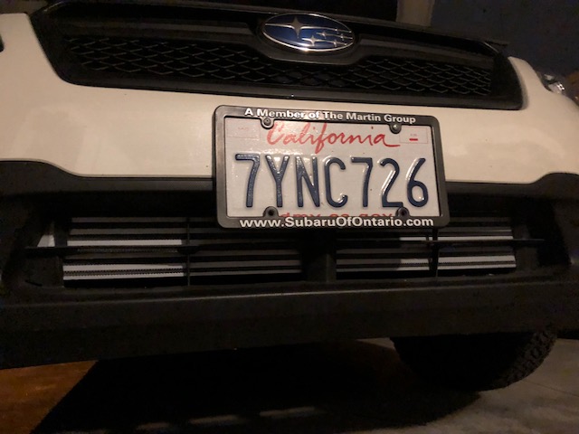

a little bit of trimming had to be done to the bumper cowl and behind the fog light covers to fit front bumper cover back on

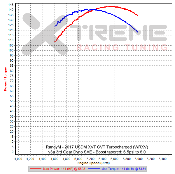

Re: RandyM - 2017 USDM XVT CVT Turbocharged (WRXV)
Posted: Sat Apr 28, 2018 4:21 am

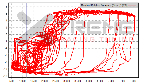

v3a Boost.png (24.87 KiB) Viewed 22013 times
v3a 3rd Gear Dyno SAE.png (32.64 KiB) Viewed 22013 times

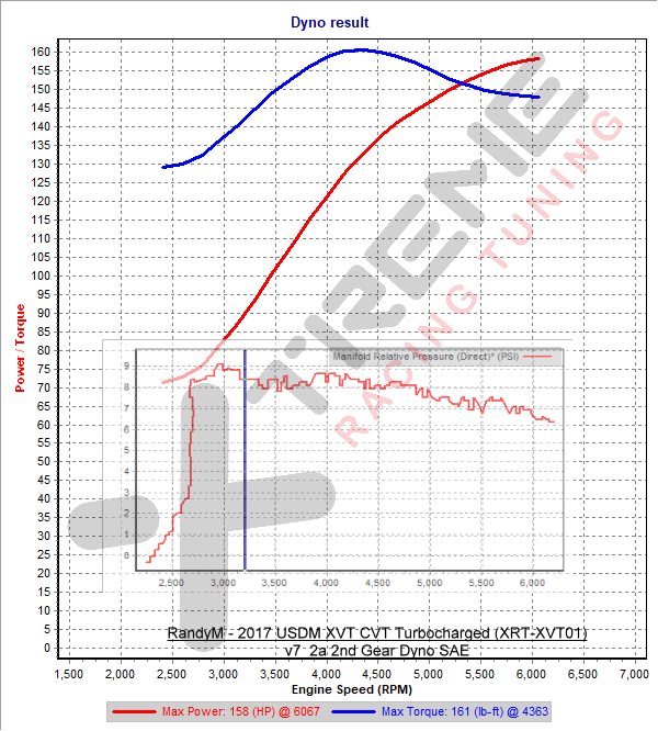

v7_2a 2nd Gear Dyno SAE.png (76.63 KiB) Viewed 21851 times
