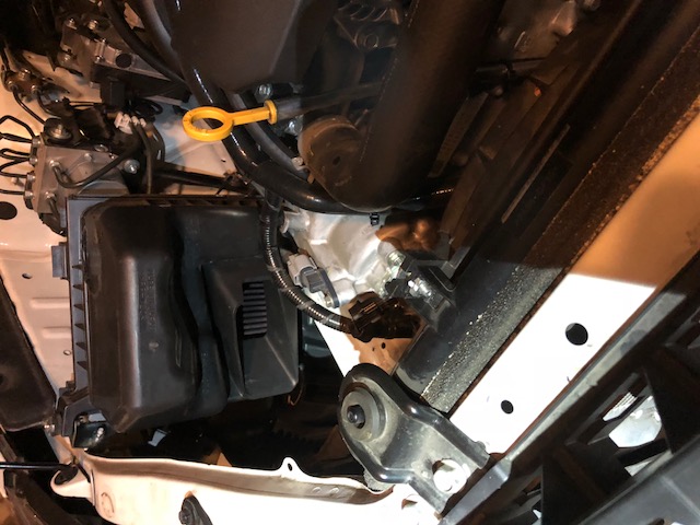

turbo drain sump vent can be teed into Mishimoto crank case vent hose (supplied with intercooler kit). right behind the AC compressor. you can see it in one of the previous photos.

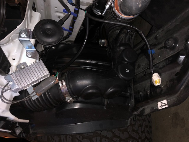

I bought a OEM 15+WRX air box and pipe but the mass airflow sensor did not fit in the WRX box, so I flipped the XV air box up side down and attached it to the WRX turbo inlet pipe, it works but I plan on fabing a custom intake in the future. They sell aluminum mass air flow bungs on ebay, XV is same as STI just not WRX

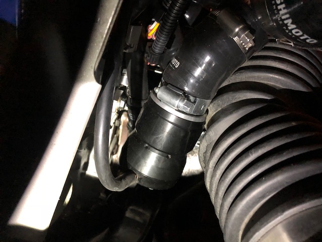

I used a GFB recirculating valve for a 15+ WRX and it installed as it would on the WRX. I ran the vacuum hose to the plugged port on the intake manifold

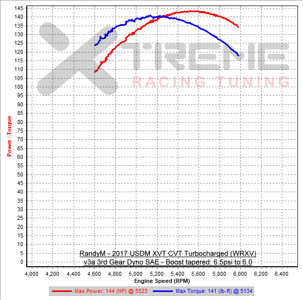

Now the car is running great. I have made some decent pulls to collect data for ED. He is doing an outstanding job!!! This is the first time anyone has tuned a 15+ NA for turbo and there are a lot of hurdles to overcome. ED is knocking it out of the park. Every time he sends me a ROM it gets better and better. His CVT tune is awesome, makes it feel like a sports car not a grocery getter.

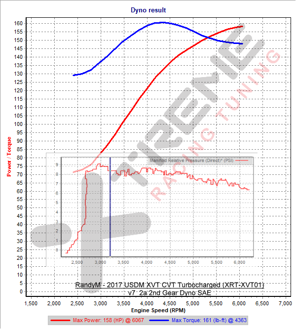

Going to put more boost in it today :D We will see what it does
