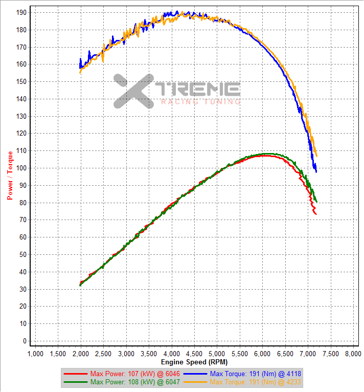

v7
V7 have greater low end torque
v7 3rd Gear Dyno SAE Accel.png (45.54 KiB) Viewed 25856 times
v7 3rd Gear Dyno SAE.png (42.22 KiB) Viewed 25856 times

I first installed in back before my surgery while I was on holidays and drove home with it. I can't really remember how v6 was but I remember having some amazing fun on the way home with v7 when I was in the high rpm range
I remember noticing some slight changes in the top end. It seemed to hold on to the power as it went over 5000rpm. When the car really starts to surge at around 4000rpm the power seems to drop away a bit at about 5000rpm. v7 felt like it improved this and helped it to hold onto the power. Instead of that fantastic surge of power between 4000-5000 fading away just as I start to enjoy it, it now seems to last longer. The combination effect of all the changes has made me think twice before planting the throttle coming out of the turns!!
I specifically remember a winding set of turns through the mountain where it was perfect to just hold in 2nd gear, working between 3000-6500rpm felt fantastic!! The car felt VERY aggressive and I went on/off the throttle and I could feel the power wanting to kick the car into under/oversteer (AWD working hard to keep me alive lol).

Those graphs are awesome Edward!! They tell such a small part of the story, the car feels FANTASTIC to drive!! The best part is re-loading the stock and feeling the boring and sluggish it is. With stock settings, I put my foot down and its like the engine takes a moment to decide what to do...and I get bored, lol.
It is like two different cars!! The way it picks up speed down in the low RPM, the extra torque and the way it immediately reacts when I touch the throttle. It's hard to describe but put it this way, I took my friend for a drive before and after v7 and had him giggleing like a school girl by the time I'd wound out 3rd!!

v9 Dynoes
v9 3rd Gear Dynoes SAE.png (32.88 KiB) Viewed 25814 times

The car felt even faster! It was hauling when I first set off with the intake temp around 18 degrees. Then it stabilized at about 23-25 degrees but it was still going really well. I noticed in particular how it behaved when cruising in 5th gear at 100km/hr. It sits at about 2600rpm and when I put my foot down it instantly starts picking up speed and pulls up hills really well. It has this real surge between 2500-3000rpm that was definitely not there before, in fact it used to feel like crap when you put your foot down in that rpm range but now its great!!
I can't get over the pull it has between 4-5000rpm. Going from 1500rpm, its a bit slow but then really picks up between 2500-3000rpm. Its a bit slow from 3000-4000 but then it takes off between 4000-5000 and that surge makes for my favourite part the car's performance.
Power seems to fade a bit as it gets higher (5000 up to 6500rpm) but it's still way better then it used to be. I absolutely love the howling noise the engine makes as it approaches 6500rpm, it says just when to change gear. I know its probably howling in pain and agony, but I don't push it that hard very often and my service intervals are now every 5000km or ~4 months (although recently I have been doing a lot of hard driving for logs...)
Biggest imporvement by far though is the low-mid range power, and I find it getting the better of me sometimes on roads that I know really well. It has made everyday driving 10x better. With a supercharger I will definitely be looking to upgrade my brakes to avoid those bowel clenching moments :shock:
To see the difference between stock and v9 still amazes me...especially considdering a stack of local places that basically told me I was an idiot and you can't improve on a so-called perfect stock tune...read the graphs and weep :wink: 98 kW - 108 kW and 172 Nm - 191 Nm.
Nice work Edward, improving on what many called "perfection" lol
v9 vs Stock - 3rd Gear Dyno SAE
v9 vs Stock - 3rd Gear Dyno SAE.png (31.29 KiB) Viewed 25813 times

turner_822 wrote:Well I had some real fun with v9c. Edward has got the car really dialed in. I will have to log some 3rd gear pulls so Edward can post the graphs but he didn't tell me what he changed for v9c.
Straight away I noticed the difference down low. The power feels so smooth now and that slow spot between 3000-4000rpm is pretty much gone. As I accelerated, it would pick up at 2500, drop off a tiny little bit at 3000, pick up again at 4000 and finally drop off at 5000. Now; the power seems to build really smoothly from 2500rpm right up to 5000 before the power fades away. It just feels like it's reving so freely because it's no longer getting held up by that slow spot between 3000-4000rpm.
Didn't really get out of town so I couldn't stretch its legs and feel for any changes in the high rpm range. I look forward to finding out in the morning though :D
