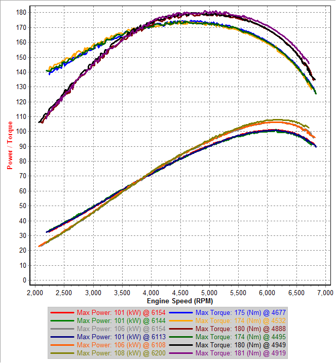

v5 Stats
v5 introduce fuel around 2700+rpm
v5 vs Stock.png (21.58 KiB) Viewed 21789 times

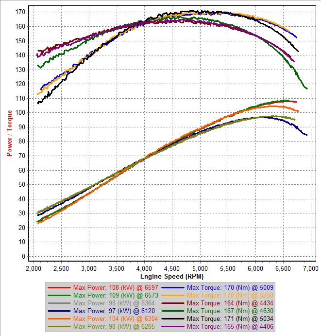

v5 vs v4.png (21.49 KiB) Viewed 21789 times

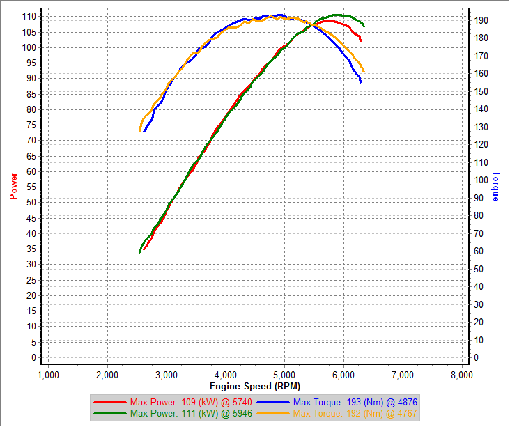

v9 Dynoes
Update sent to customer free of charge
Dynoes are up and down a road
IAT's are very hot. Previous dynos were done around 17C. The dynoes are around 39-34C with an average of 35C. So power and and TQ will be low.
v9 3rd Gear Dynoes IATs=39-34C.png (30.28 KiB) Viewed 21554 times

The v9 ROM was good. Initially I didn't think there was any noticeable difference. I didn't notice anything until I had something to compare against, and in this case it was simple overtaking of other cars.
I've had five months to get used to the v8 ROM in day to day driving, so that's what it took to really notice what was new - more general driving. At 3,000rpm the car is picking up a little faster than before.
At 4,000rpm, the car feels a little meater there too, with the RPMs picking up quickly. The car feels a little more eager and pulls away harder than before making overtaking easier than before. The overall difference is not massive, but it is there and it feels nice.
In doing the third-gear pulls, I initially didn't really feel anything different by the seat of my pants, but the speedo did appear to be showing a faster speed than I remembered the v8 tests were. As before however, I ran out of road and was not able to pull right up to the new redline.
So in short, the changes are definitely noticeable down low and in the mid-range but nothing new up top. I have to also say I'm particularly impressed with how the car is running despite our local temperatures at the moment - it's 29 degrees with very high humidity tonight. Great performance!

west_minist wrote: Dynoes are up and down a road
It's a road with a long slight curve going slightly up and then slightly down. Sadly, it's the flattest road near me that won't attract unwanted attention while doing runs without having to drive an hour out of town.
I did three runs in both directions each. Shows up quite blatantly in the graphs, doesn't it!
west_minist wrote: IAT's are very hot. Previous dynos were done around 17C. The dynoes are around 39-34C with an average of 35C. So power and and TQ will be low.
Yep, that's Australian summer nights for you. Last night's humidity was so bad you could almost swim in it.
The car still feels great despite these temperatures. Under the stock tune, bogging down in hot weather was just something you put up with - it was always unpleasant, but not with Edward's tune. I should also add that the car still accelerates really well with the air-conditioning turned on! There's almost no difference whatsoever! :D
Over the next month or two our temperatures will begin to cool as we head into Autumn (or Fall for those more familiar with American terms), so even once Edward has confirmed that all additional work has been completed, closing the chapter on my tune, I'll get some more logs sent to him later so he can put together some final comparative graphs against the temperatures we originally tuned with.

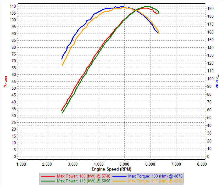

v9a Dynoes
v9a 3rd Gear Dyno IATs=28-24C.png (31.35 KiB) Viewed 21551 times
