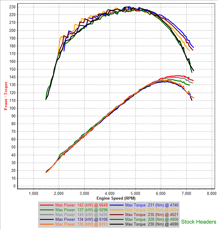

Bill - 2006 ADM Subaru Legacy 3R 6MT - Tuning
v11a Stats
v11a 3rd Gear Dynoes IAT=27-24C.png (23.3 KiB) Viewed 8113 times

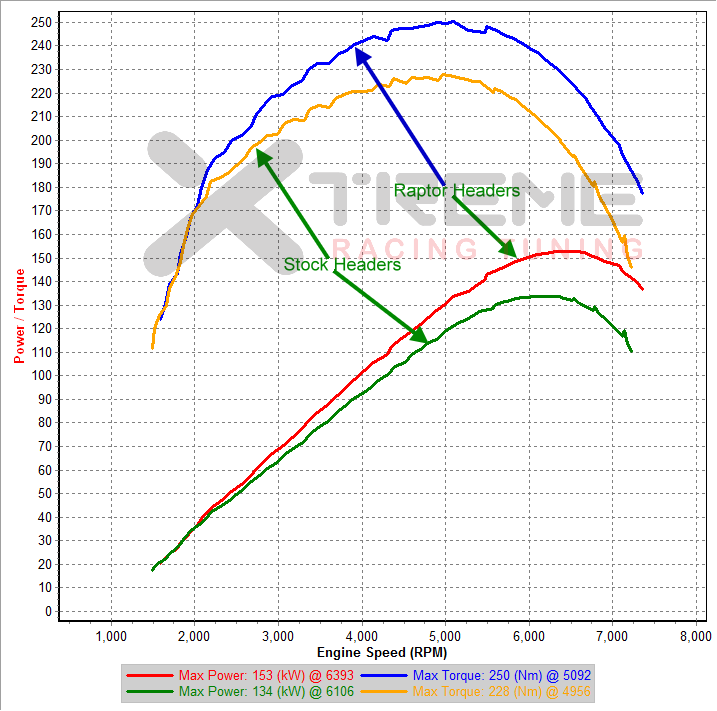

Raptor Headers v2
v11a 3rd Gear Dyno IAT=27-28C Headers vs Stock Headers.png (34.2 KiB) Viewed 8086 times
Ignition Tuning
Added 2 - 4 degrees to the timing adv maps.
v11c 3rd Gear Dyno - Raptor Header vs Stock Header
v11c 3rd Gear Dyno - Raptor Header vs Stock Header.png (53.45 KiB) Viewed 7628 times
