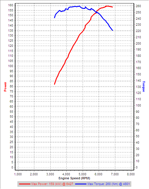

More timing added with the new headers and the car is very responsive now. :D
v24 3rd Gear Dyno IAT=33C
Posted: Tue Mar 15, 2011 8:29 am
v24 3rd gear Dyno IAT=33C.png (18.16 KiB) Viewed 21998 times
