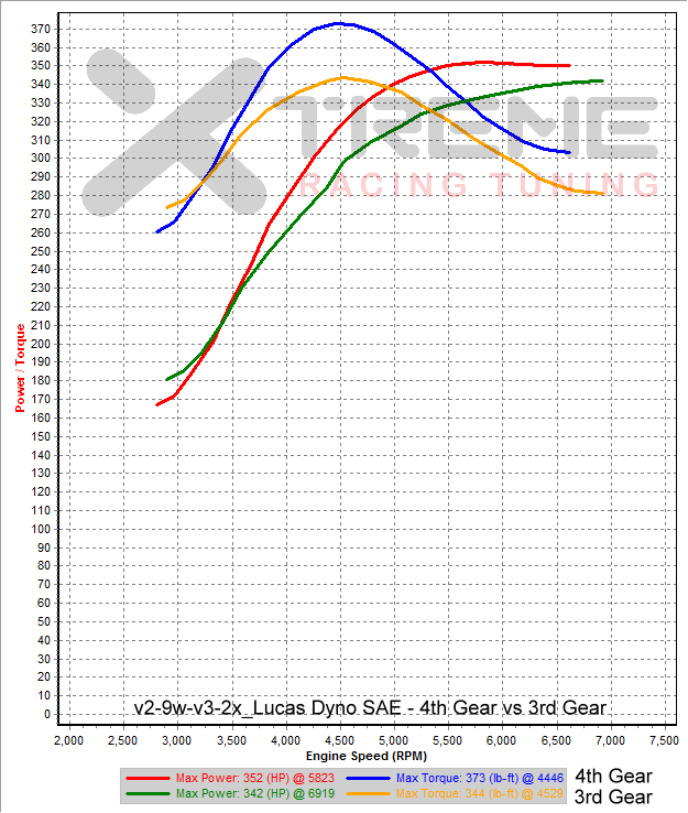

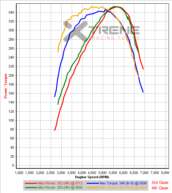

Posted: Fri Mar 05, 2010 8:24 pm
v2-9w-v3-2x_lucas 3rd_4th Gear Dyno Comparison.png (20.88 KiB) Viewed 22411 times
3rd Gear @ IAT=34C : 4th Gear @ IAT=33C

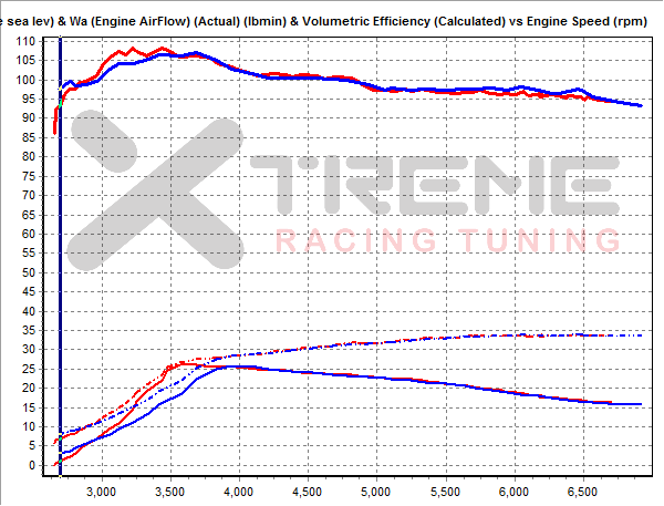

v2-9w-v3-2x_lucas 3rd_4th Gear Dyno Comparison SAE
Posted: Mon Aug 06, 2012 10:12 pm
Engine Ve vs Engine Flow vs MRP
v2-9w-v3-2x_lucas - ve vs boost.png (18.81 KiB) Viewed 21387 times
v2-9w-v3-2x_lucas 4th vs 3rd Gear Dyno Comparison SAE
v2-9w-v3-2x_lucas 4th vs 3rd Gear Dyno Comparison SAE.png (38.45 KiB) Viewed 21387 times
