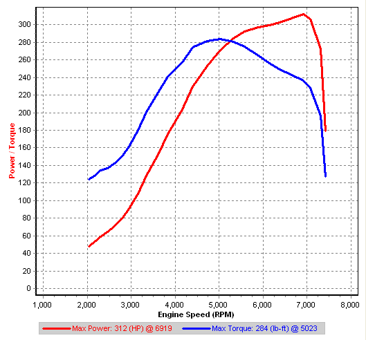

The car mods:
Stock EJ207 on stock turbo.
Aftermarket:
APS front mount intercooler dr 725, APS Cold Air Intake, Custom catted downpipe (HKS Replica) 3.5, GReddy Power Extreme II 3.5 exhaust, #8 NGK Sparks

- R1-0 Road Dyno
Boost @ 19.5psi
IAT @ 32C - R0-1-dyno.png (11.37 KiB) Viewed 5192 times
