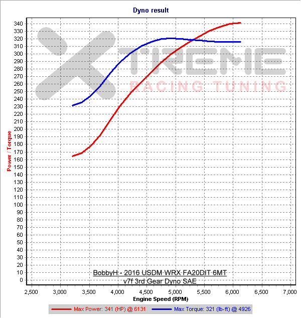

BobbyH - 2016 USDM WRX FA20DIT 6MT
Owner: BobbyH
Version: Cobb AP v4
Tyres: 245/40R18
Car Weight: 1506kg
Driver Weight: 79kg
Total Weight: 1585kg
https://www.facebook.com/XtremeRacingTu ... 0699282447
Perrin turbo inlet
Cobb Cold air intake
3" MAP J pype
3" borla exhaust
TGV delete
EGR delete
Mainly H Turbo enough Connecting rods
Mainly B series forged pistons
ACL race bearings
Killer B oil pickup
Equal length 2 1/4 inch headers
FA20 Blue 73mm twin-scroll turbo
Grim speed boost controller
Tile 50mm Recirculation/ Atmosphere BOV
ETS Front mount in are cooler
Torque solution motor tranny and pit stop
AEM water meth
Air oil separator
Short throw shifter
Drilled and slotted brake rotors ceramic pads
Pro lite flywheel
AC 6 park friction desk
AC pressure plate
Parents turbo inlet
v7f 3rd Gear Dyno SAE
v7f 3rd gear Dyno SAE.png (27.46 KiB) Viewed 8032 times
