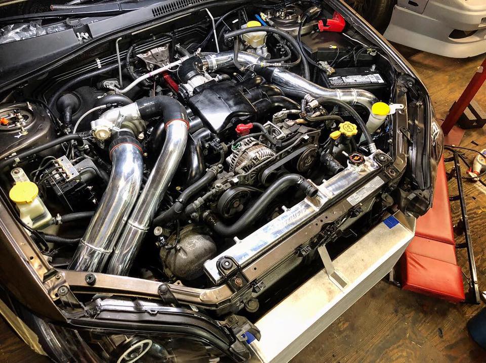

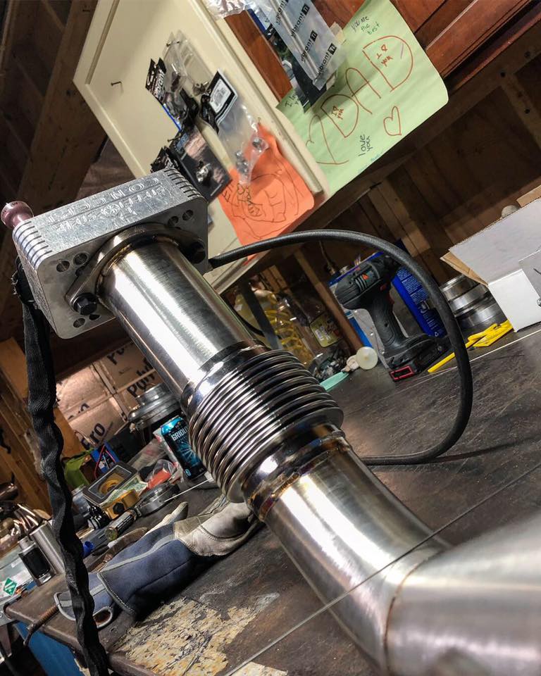

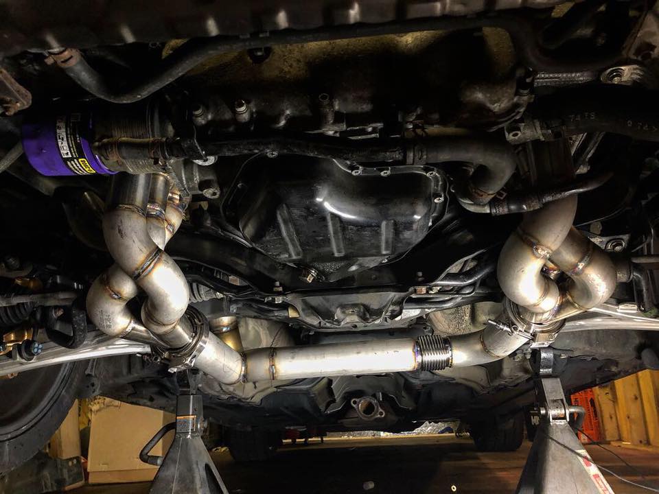

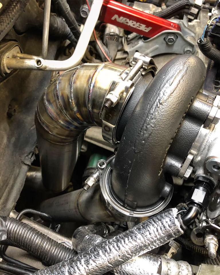

Borg Warner 7163 turbo

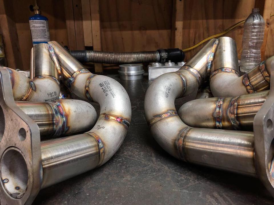

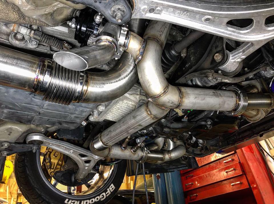

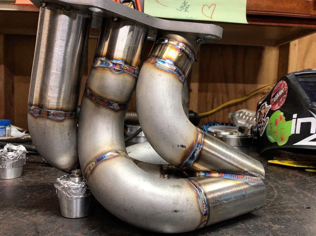

Jonathan Dillard H6 3.0 Turbo Headers w/ Up-Pipe

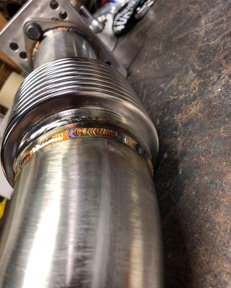

Jonathan Dillard H6 3.0 BW7163 Down-Pipe
ETS 4 inch Front Mount intercooler
Jonathan Dillard Custom Boost System Piping
GFB Borg Warner BOV - Not installed Yet
Tial 44MM External Wastegate
Omni 4 bar MAP
3.6R MAF
Aem Oil temp gauge
Aem Oil pressure guage
Innovate Motorsports DLG-1: Dual Lambda (Air/Fuel Ratio) Gauge
Greddy Profec Boost controller
Block8head custom pillarpod
Mishimoto oil cooler( motor)
Mishimoto oil cooler (trans)
Cusco oil Catch can

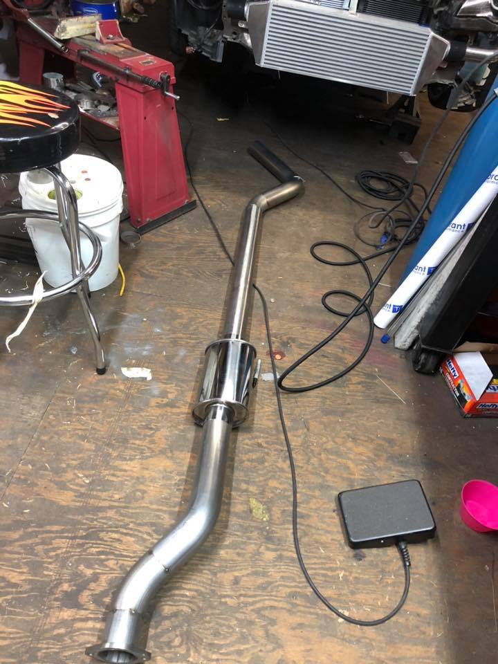

1x 3inch vibrant ultra quiet resonators
2x 3in inlet vibrant titanium tips 4in Tip
2x denso Afr sensors 234-9047
STi pink injectors 600cc
Deatschwerks fuel pump - Not installed

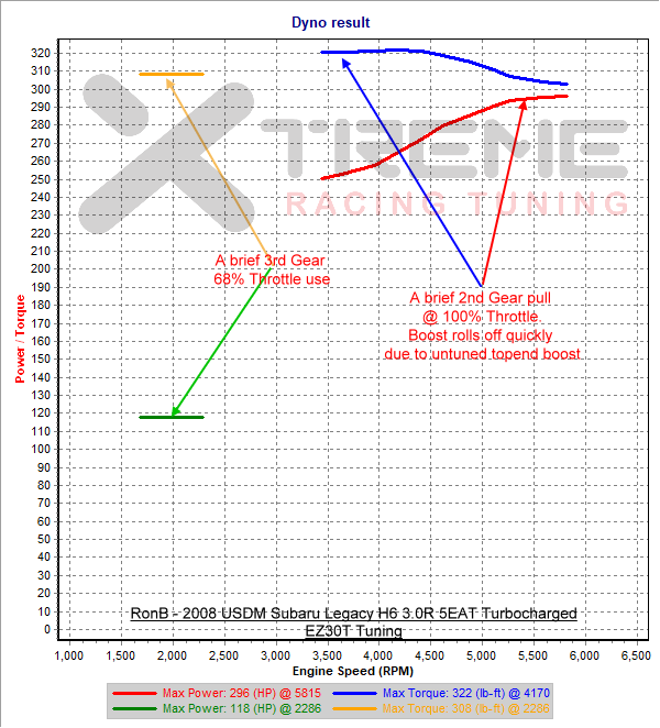

BW EFR 7163 EZ30T
RonB - 2008 USDM Subaru Legacy H6 3.0R 5EAT Turbocharged - EZ30T Tuning.png (47.29 KiB) Viewed 15798 times
