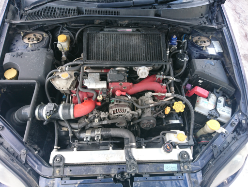

AnttiS - 2004 JDM Subaru Legacy 2.0GT 5EAT
Owner: AnttiS
Rom: A2ZJD02A
Tyres: 215/45-17
Car Kerb Weight: 1601kg
Driver Weight: 110kg
Total Weight: 1711kg
https://www.facebook.com/XtremeRacingTu ... 2412584282
XRT Stage 2.5
XRT 5EAT Tuning
E85 Tuning
Big turbo 55mm comp wheel 56mm exh wheel and #11 exhaust housing, its modified Lateral Performance MD321V
Japspeed UEL header
3" turbo back exhaust
MY08 STI Top mount intercooler
Injector Dynamics ID1300x with MY08 fuel rails,
MY08 STI aluminium intake manifold and fuel lines installed as parallel.
320lph pump external fuel pressure regulator (i have now adjusted it to 3bar without vacuum, its 1:1 with pressure control)
CP pistons 8.5:1, H-beam forged rods, genuine new Subaru 12200AA390 crankshaft
Head ports and combustion chambers modified
76mm MAF piping from air filter to turbo

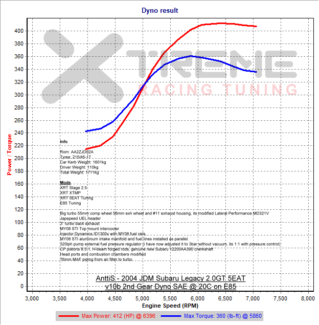

Re: AnttiS - 2004 JDM Subaru Legacy 2.0GT 5EAT
v10b 2nd Gear Dyno SAE @ 20C E85
