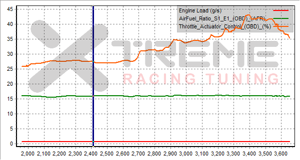

With the current mods and now fuel review, the car is running very lean.
Lean condition.png (16.58 KiB) Viewed 16123 times
