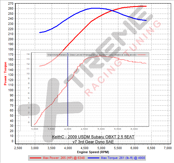

KeithC - 2009 USDM Subaru OBXT 2.5 5EAT

V3-5 were my issues chasing a mysterious intake leak. Once this was correct my issues disappeared. Car continues to make more power and have better response.
V6- 18.5psi feels incredible while in drive and with sport. As the vehicle makes more power the paddle downshift and upshift becomes more crisp. Car is over 300whp at less than 6500 RPM.
Edward is doing fantastic. Will upgrade wastegate spring from 11 psi to 18 psi and hopefully tune for 20psi on Nevada 91 octane!
Will post video after next update.
