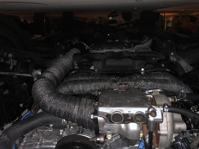

Prefab used turbo and manifold from FA20DIT
bolted right up just had to move the center bolt holes over about 8MM and use some redneck engineering to put a couple small dents in the oil pan

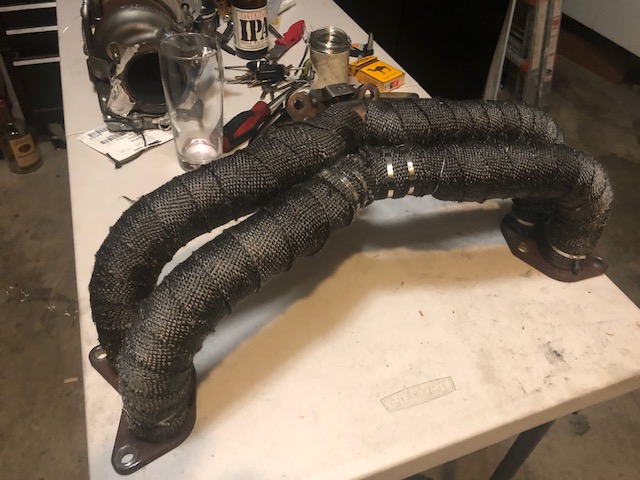

Heat shields removed due to clearance issues, and heat wrapped.

down pipe fabricated and mounted in the car. I used a high flow cat and OEM O2 sensors. I also added a Innovative wide band O2

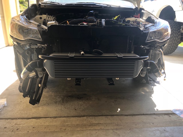

Mishimoto 15+ wrx intercooler kit, Bolted right up to the car with all supplied parts except a silicone 90 and a silicone 12 inch straight were needed at the throttle body, due to it being in a different position than WRX
