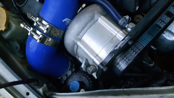

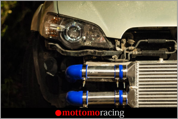

- Rotrex C38-81
- 65mm Pulley
- Stock MAF mounted in 76mm pipe before SC
- 550x230x65mm Intercooler: http://fmic.pl/jednostronne/279-interco ... x65mm.html
- Cone filter
- Supertech 8.5:1 Pistons
- 76mm piping before SC, 63mm after (incl. IC)
- MAP mounted in stock place in intake manifold
- OEM Subaru Dump Valve (from Forester turbo), return pipe goes into pipe just before SC but after MAF
- Deatschwerks DW200 fuel pump
- STI Pink injectors
- Full (headers&catcack) custom 2.25" exhaust with 2 Magnaflow CATs

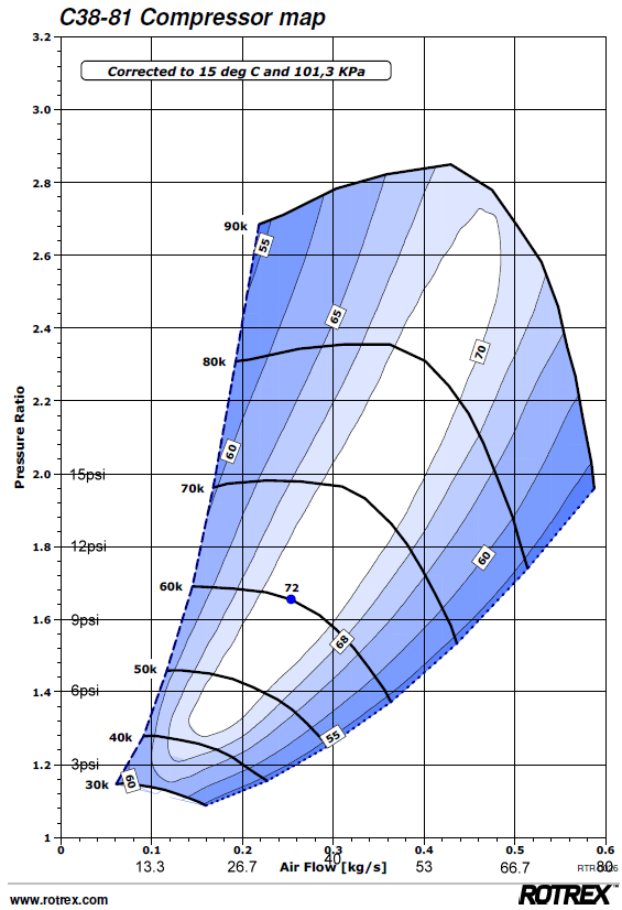

Rotrex C38-81
Power: 220-485kw (300-660hp)
Max Flow: 0.58 kg/s (1004CFM) (77lb/min)
Max Presure Ratio: 2.85

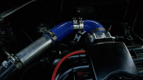

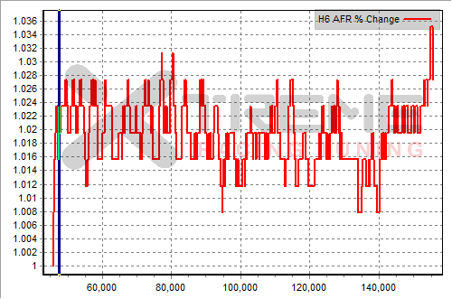

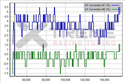

Good news. All leaks been sorted and MAF tubed changed from 76mm to 80mm.
In addition, the broken vacuum line to the Fuel Pressure Regulator was fixed. Idle is currently stable and correction perfect to this setup.
v4h H6 AFR Correction.png (13.64 KiB) Viewed 26108 times
v4h H6 AFR 5 Change.png (13.8 KiB) Viewed 26108 times

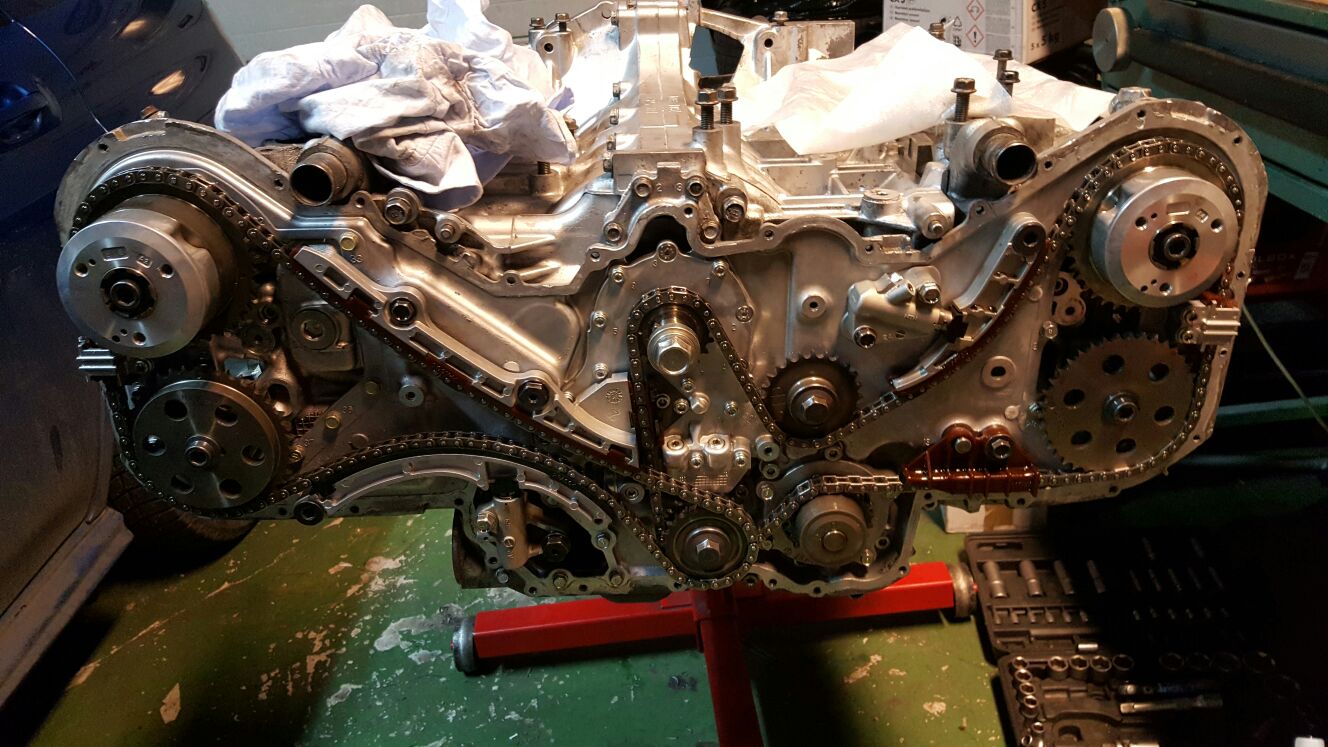

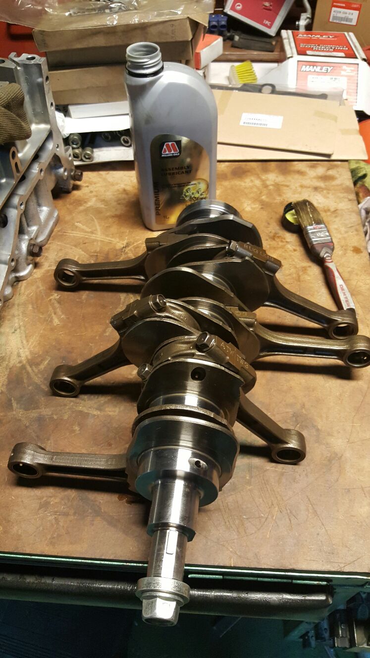

Re: BartoszB - 2004 EDM Subaru Outback H6 3.0R 5EAT - SC Tuning

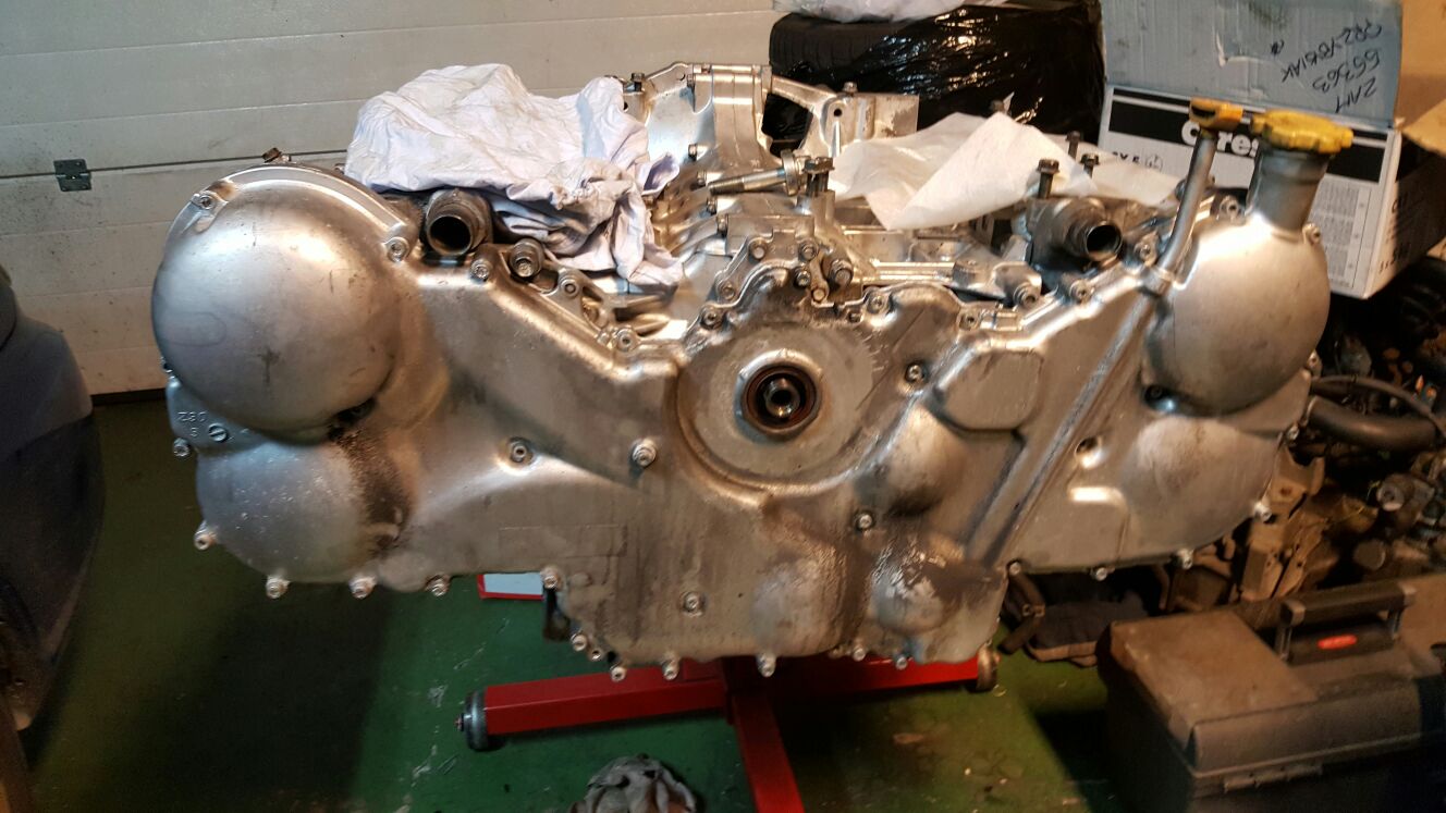

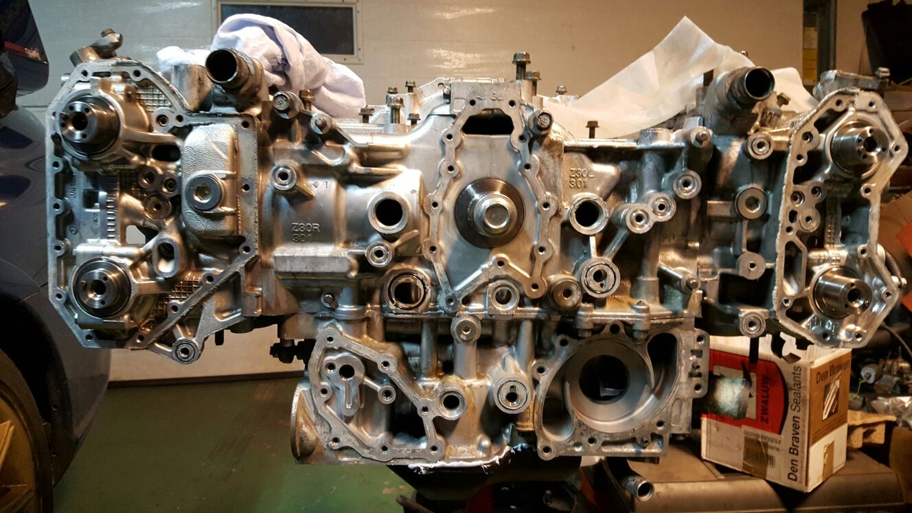

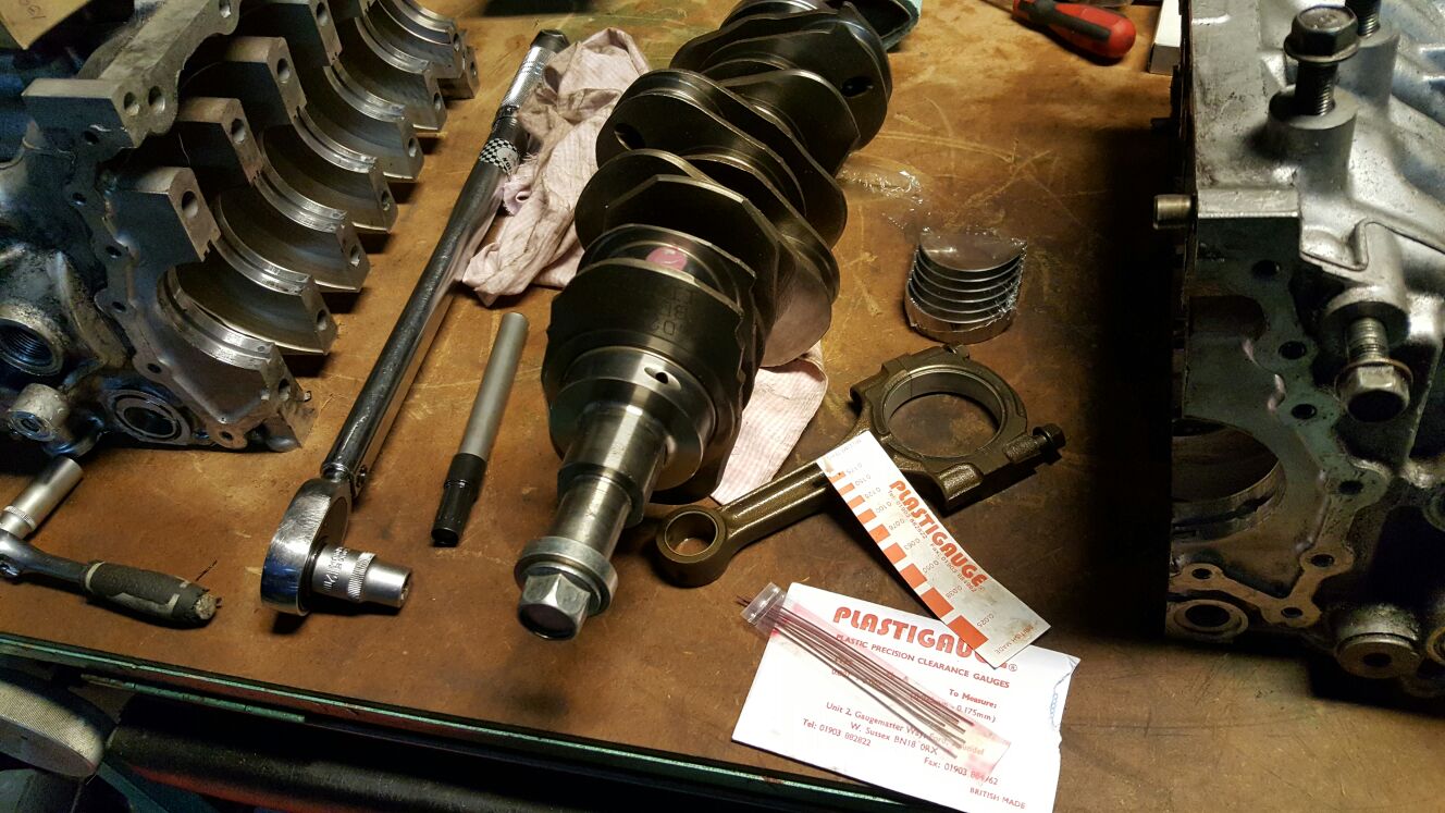

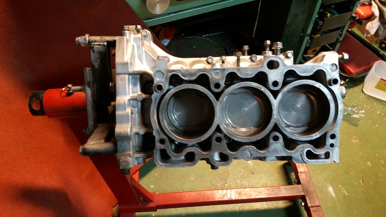

Engine rebuild.

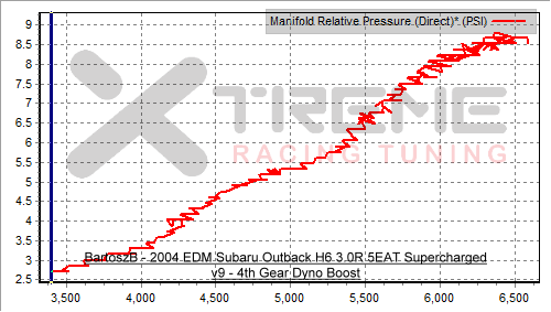

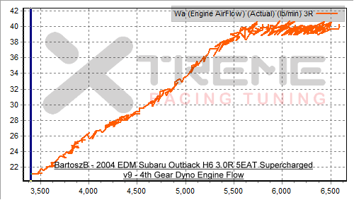

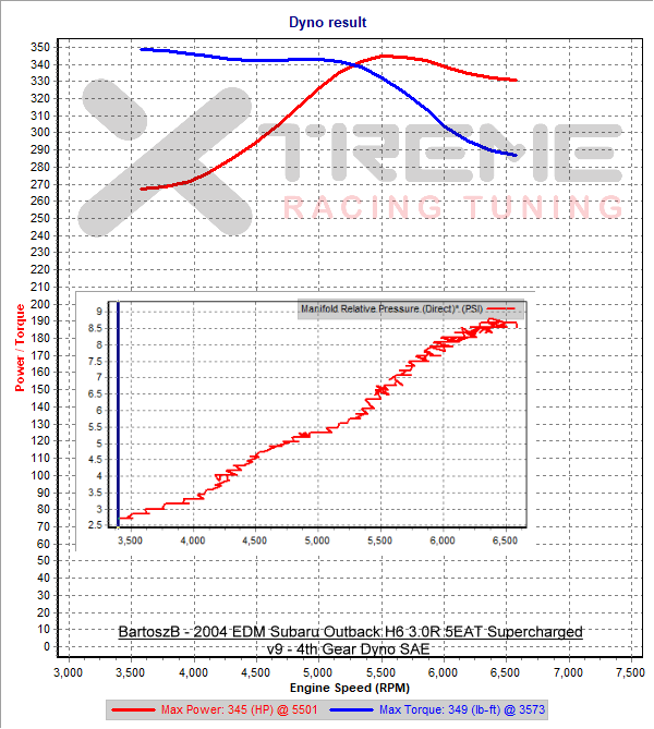

Tyres: 245/45r18
BartoszB v9 4th Gear Dyno.png (56.12 KiB) Viewed 23976 times
BartoszB v9 4th Gear Dyno Boost.png (23.9 KiB) Viewed 23976 times

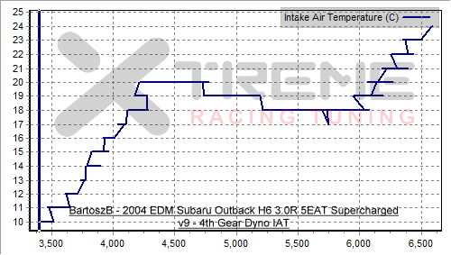

BartoszB v9 4th Gear Dyno IAT.png (21.03 KiB) Viewed 23976 times

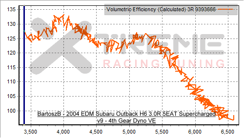

BartoszB v9 4th Gear Dyno VE.png (22.59 KiB) Viewed 23976 times
BartoszB v9 4th Gear Dyno Engine Flow.png (22.15 KiB) Viewed 23976 times
Last dyno and we are at 380whp, but awaiting further logging, but the car been delivered to the owner on his B'day!
