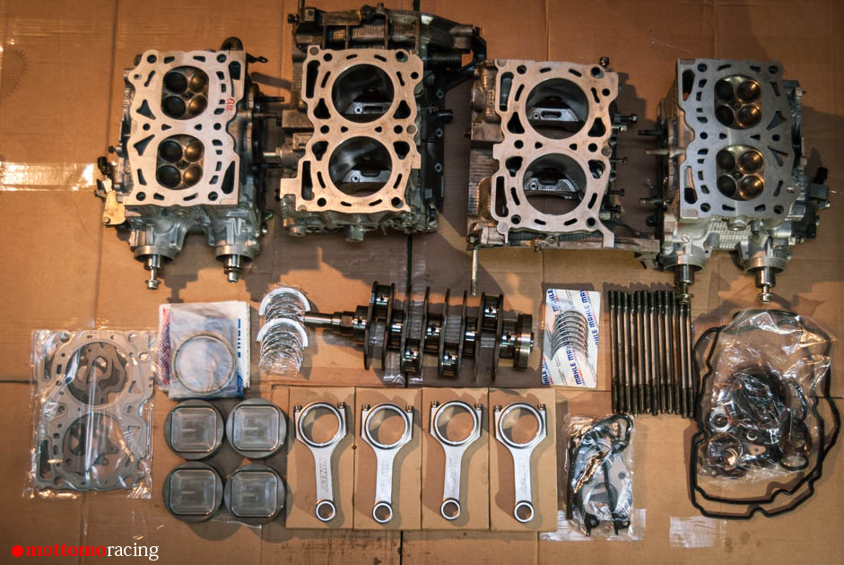

Displacement: 2.2L
EJ20 closed deck w/ EJ257 heads
EJ257 Nitrited crank
Manley rods
Mahle stroker pistons
OEM Spec-C main bearings
Mahle WRC-spec rod bearings
AVCS heads (intake) (EJ257)
TGV deletes
Injector Dynamics ID1050x
Fuel Pump Walbro 255lph
Stock fuel pressure regulator
stock EJ257 intake and sensors

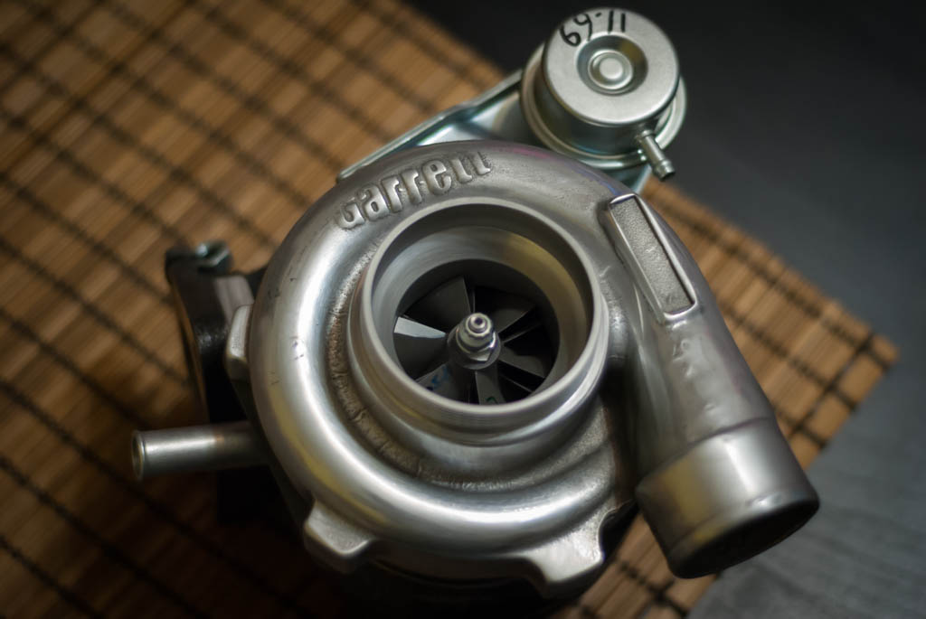

ATP GT3071R turbo stock location
Stock STI TMIC
Forge BOV
Cobb 3-Port EBCS
3" bellmouth dp no cat
3" straight through exhaust
Mishimoto cooler
Spec-C IC auto spray

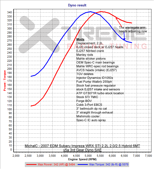

Turbo related info

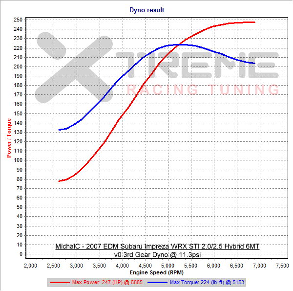

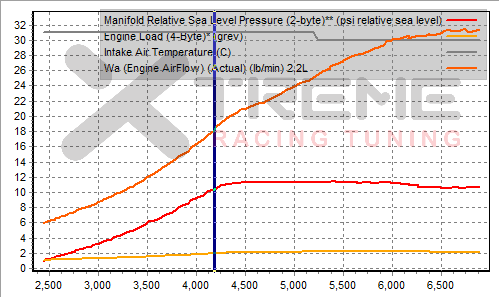

v0 3rd Gear Dyno
v0 3rd Gear Dyno Critical Data.png (14.7 KiB) Viewed 18034 times
v0 3rd Gear Dyno @ 11.5psi.png (32.45 KiB) Viewed 18034 times

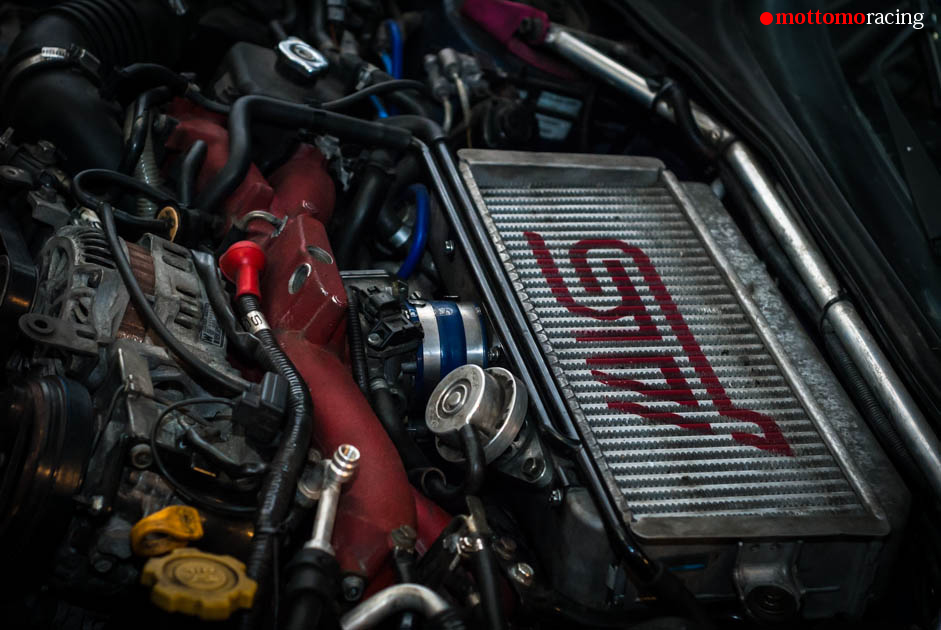

Re: MichalC - 2007 EDM Subaru Impreza WRX STI 2.0/2.5 Hybrid 6MT

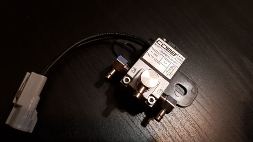

The stock EBC is being replace w/ 3-port EBCS
Cobb EBCS.png (206.49 KiB) Viewed 17996 times

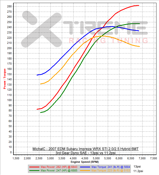

13psi vs 11.2psi - 3rd Gear Dyno SAE
v3 3rd Gear Dyno SAE @ 13psi.png (39.7 KiB) Viewed 17988 times

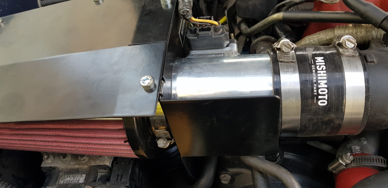

Awaiting MAF housing upgrade.
Upgraded 70mm MAF
70mm MAF.jpeg (123.45 KiB) Viewed 17660 times
v5a 3rd Gear Dyno SAE
v5a 3rd Gear Dyno SAE.png (76.78 KiB) Viewed 17589 times
