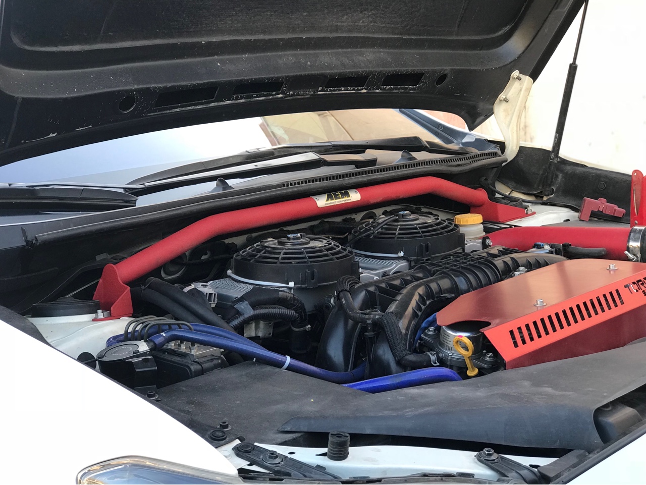

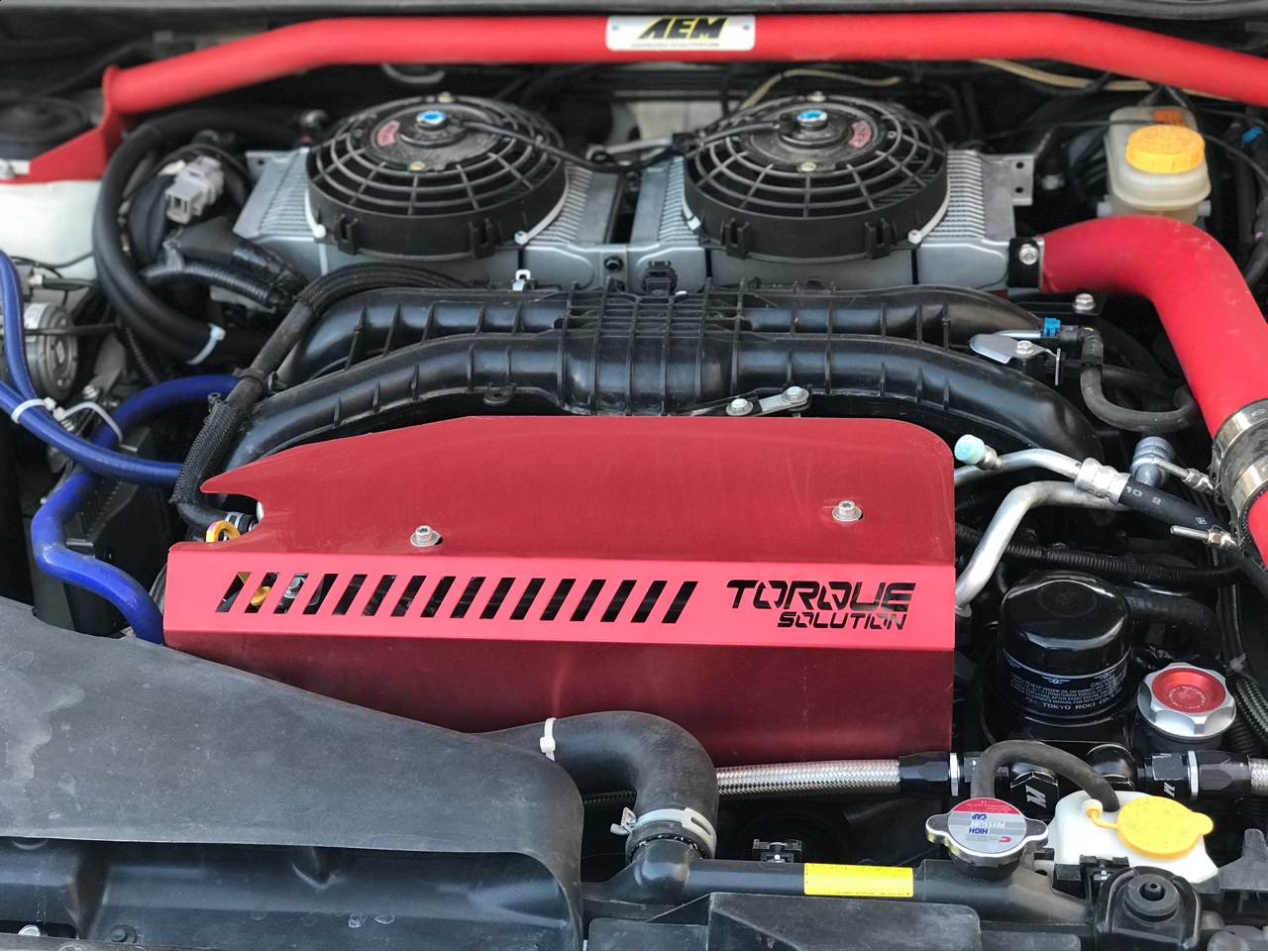

Engine
  • CP piston SC7406+ 10.3:1 CR
  • Manley Rods 14431
  • Engine Bore Size: 87mm
Exhaust System
  • Perrin Headers
  • Invidia Q300 C Turboback
  • Nameless J-Pipe
Intake System
  • ETS CAI
Boost
  • Grimmspeed EBC
  • TurboXS FMIC
  • Nameless BOV
  • Turbocharger: Steamspeed STX 67+ Version 2 + Turbosmart IWG-75
Coolers
  • Mishimoto Engine Oil Cooler
  • Mishimoto Transmission Oil Cooler

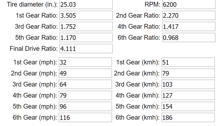

Re: TariqA - 2015 Subaru WRX FA20 DIT CVT
CVT S# Speed.png (104.38 KiB) Viewed 12141 times
