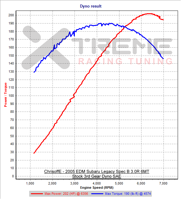

Stock 3rd gear Dyno SAE.png (32.08 KiB) Viewed 18952 times

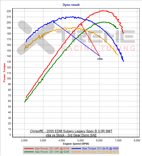

Retuned on STI Pink Injectors
v9a 3rd Gear Dyno SAE.png (38.84 KiB) Viewed 18951 times
