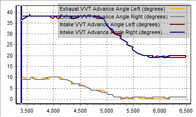

Review of rom:
  • Extremely rich - Cold start, cruising and etc were affected due to this excessive rich nature
  • Low Ignition Timing
  • Lack of Intake AVCS optimisation around 6000 and +
  • Lack of Exhaust ACVS optimisation in low rpm range
  • Non-Removal of rom limits to allow for safe tuning
  • Lack of good Engine Torque Request to allow for quicker and firmer shift. This can lead to clutch burning from the increase of torque the engine is making and slow clutch engagement. In many areas, it was even lower than the stock ROM
  • Stock OEM pump duty cycle was configured to operation at 100% all the time, even at idle
Dual AVCS.png (6.44 KiB) Viewed 24309 times

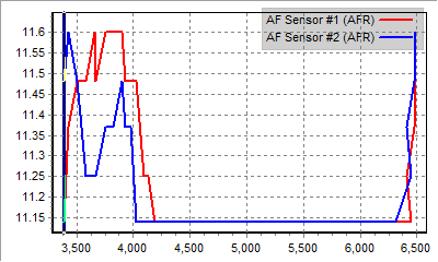

AFR #1 & AFR #2 shows some level of variance. Either an intake leak or header leak. AFR response times means there should be replaced.

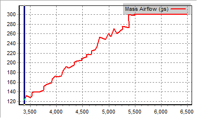

v3 MAF.png (8.18 KiB) Viewed 24308 times
v3 AFR.png (8.39 KiB) Viewed 24308 times
Request the customer to change plugs since the car been running extremely rich for a long period of time.

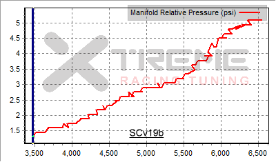

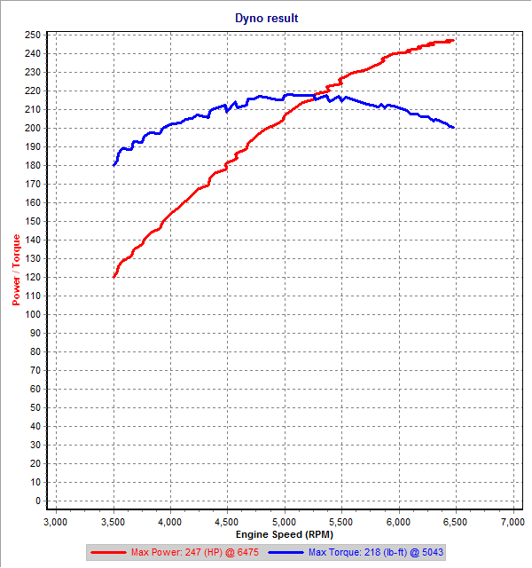

V19 Data
v19b 2nd Gear Dyno boost.png (8.94 KiB) Viewed 24122 times
v19b 2nd Gear Dyno SAE.png (100.94 KiB) Viewed 24122 times
