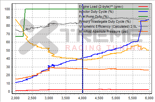

Stock Data
Stock Data #1.png (16.13 KiB) Viewed 9899 times

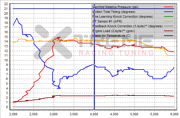

Stock Data #2.png (19.22 KiB) Viewed 9899 times

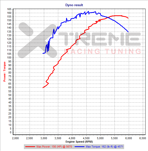

Stock 2nd Gear Dyno SAE.png (23.21 KiB) Viewed 9899 times
