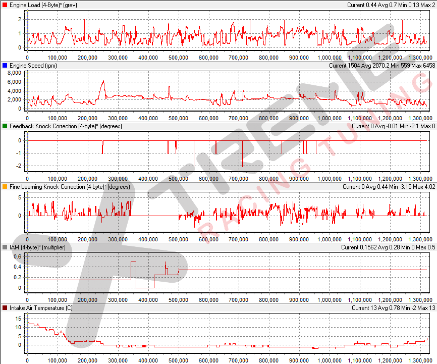

Stock Performance Data.png (88.09 KiB) Viewed 3673 times

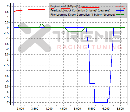

Stock Knocking issues.png (14.7 KiB) Viewed 3654 times

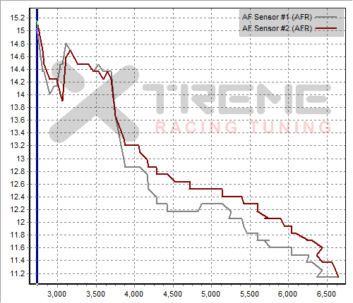

Stock AFR differences.png (15.09 KiB) Viewed 3654 times

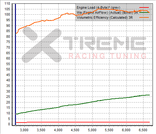

Stock VE_Wa Data.png (15.14 KiB) Viewed 3654 times

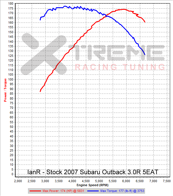

Stock 2nd Gear Dyno SAE.png (32.05 KiB) Viewed 3649 times
