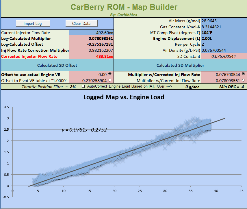

SD Mapping 1.png (106.64 KiB) Viewed 18412 times
SD Mapping 1_1.png (76.85 KiB) Viewed 18412 times

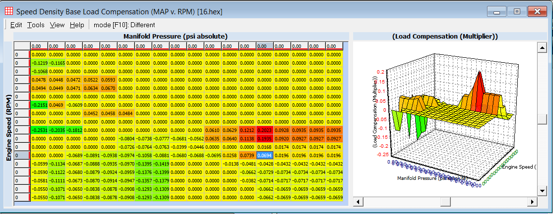

v16 SD.png (79.49 KiB) Viewed 18408 times
v16 SD-diff.png (54.83 KiB) Viewed 18408 times
sd log mapping.png (73.85 KiB) Viewed 18408 times

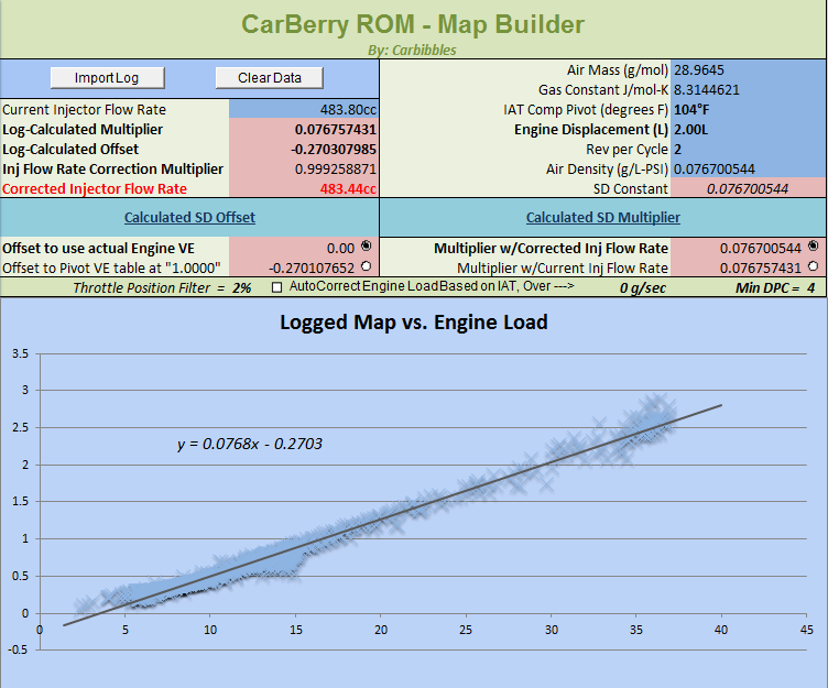

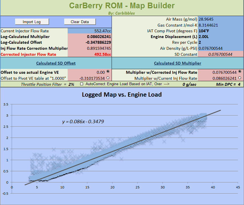

SD config from SD Engine Load
SD Calc from SD Eng Load.png (92.41 KiB) Viewed 18396 times
SD Calc from SD Eng Load - mapping.png (110.73 KiB) Viewed 18396 times
v17 SD MAP
v17-SD Map.png (79.06 KiB) Viewed 18389 times
v17-SD Map-main.png (57 KiB) Viewed 18389 times

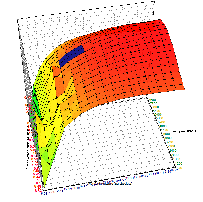

v17 vs v18 SD 3D Map
v17 SD.png (52.49 KiB) Viewed 18389 times
v18 SD.png (47.5 KiB) Viewed 18389 times
v19 SD: To be tested
Still a lot of work for idling and cruising
v19 SD.png (53.56 KiB) Viewed 18389 times

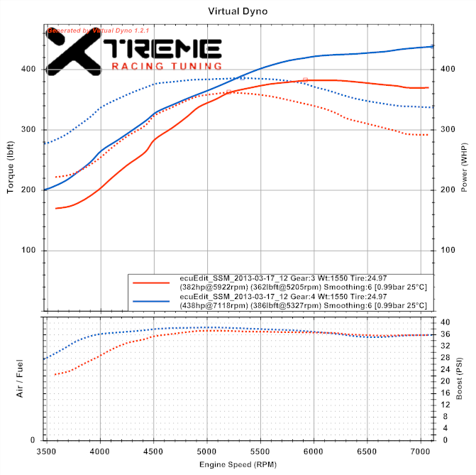

v18 3rd Gear Dyno
Re: XRT Subaru STI-03 w/ XRT-GpN Variant ROM w/ LC + AL
sti-v28g-coolant 3rd Gear Dyno SAE.png (22.37 KiB) Viewed 17555 times
sti-v24 4th vs 3rd Dynoes SAE #1.png (55.26 KiB) Viewed 17512 times
