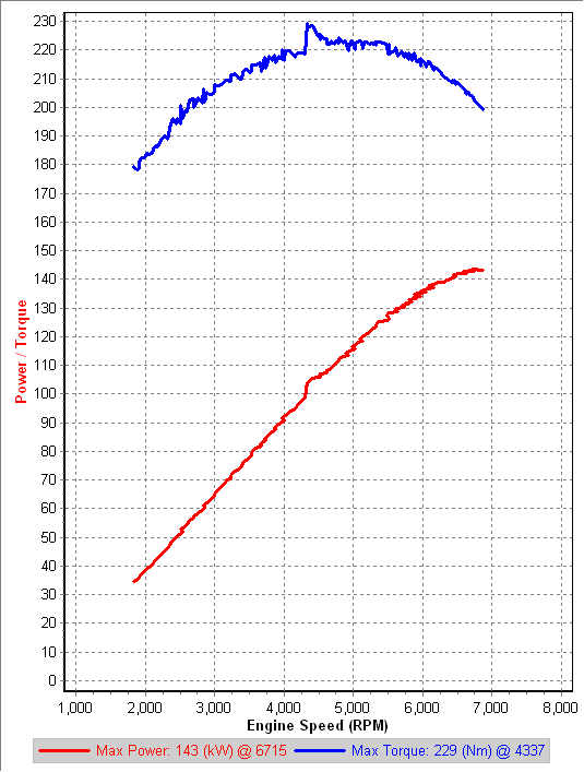

v0 Stats
For the Dyno, total weight in the car was 163kg. 1/4 Tank of 98 Gas.
V0 Engines Stats.png (25.68 KiB) Viewed 12507 times
v1 Stats
Full tank of Gas. Doesn't seem the same quality. IAM is now at 1. So all the ign Adv. is being added now.
V1 Engines Stats.png (25.94 KiB) Viewed 12507 times
v1 3rd Gear Dyno SAE.png (16.11 KiB) Viewed 12065 times

v3 Stats
Ok. Logs getting slowly clean.
V3 Engines Stats.png (24.63 KiB) Viewed 12507 times
v3 3rd Gear Dyno SAE.png (16.13 KiB) Viewed 12065 times

Scv9 vs NA-v2 3rd Gear Dyno SAE
A better cooler to be install + minor exhaust leaks to be rectified
scv9 vs NA-v2 - 3rd Gear Dyno SAE.png (58.49 KiB) Viewed 12032 times
