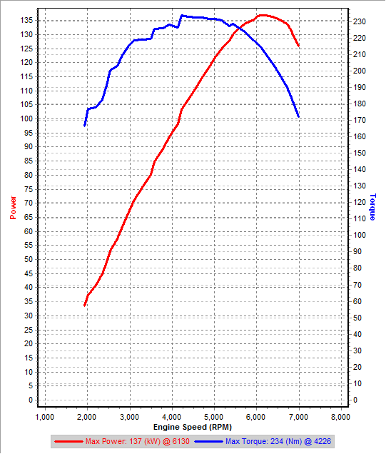

2nd Gear Dyno Stock IAT=25C.png (16.12 KiB) Viewed 13337 times
Still downhill in the end, which would rise power a bit

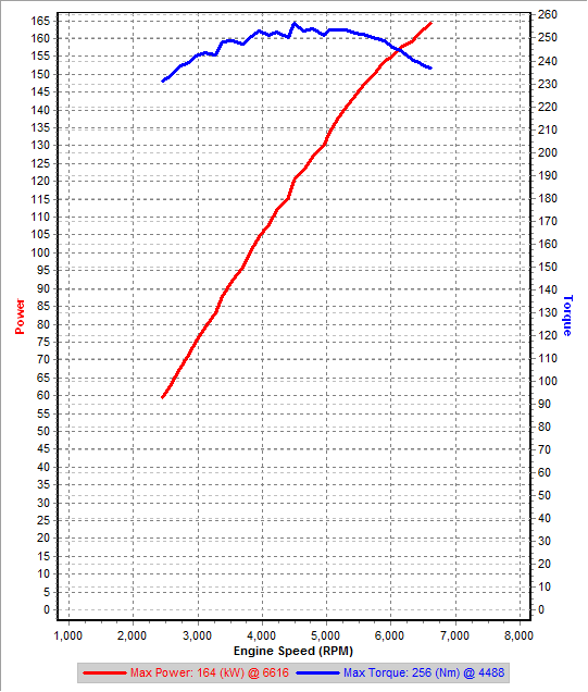

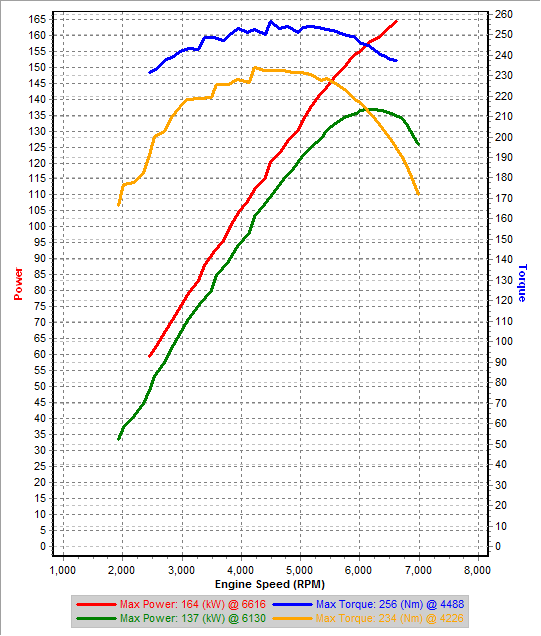

EZ30RB wrote:Edward sent me a v1 this morning, and can say that the improvements are fantastic. The car pulls smoother and harder down low between 2-4K, picking up speed much easier than before and the flat feeling you get occasionally is gone. Pedal feel is better and more crisp, and you don't need as much pressure to build up speed. Higher revs also feels more crisp and elastic and the engine sounds great on song. I found myself wanting to go faster and faster ;) This is only v1 as well!
v1 vs stock - 3rd gear Dyno.png (19.91 KiB) Viewed 13332 times
v1 3rd Gear Dyno IAT=19C.png (16.63 KiB) Viewed 13332 times

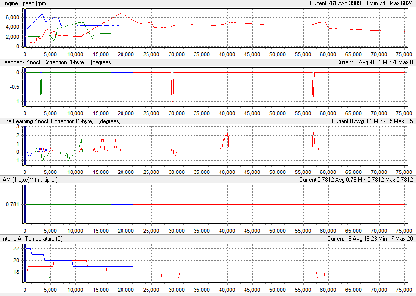

v1 stats.png (21.35 KiB) Viewed 13332 times
v3 Stats
v3 stats.png (19.49 KiB) Viewed 13326 times

EZ30RB wrote:v3 is uploaded. The engine note has changed and sounds stronger and more roar up high. Very nice.
In gear acceleration feels stronger and more responsive.
Totally different and completely better drive compared to stock.

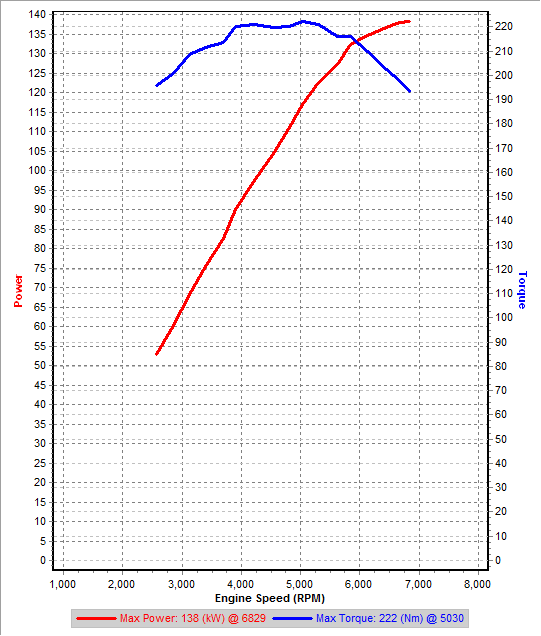

v5 Stats
v5 2nd Gear Dyno IAT=14C.png (16.05 KiB) Viewed 13323 times

ez30rb wrote:Tuning is pretty much complete.
With V5, the car is a pleasure to drive. I don't want to stop driving and cannot help push the car hard as the power delivery is so much smoother and stronger.
The final v6 is to be uploaded later today.
