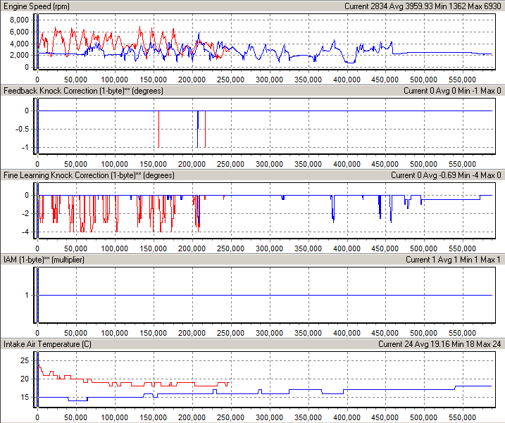

All dyno'es are based on RPM.
Stock 3rd gear Dynos Combine
Stock performance critical stats.png (19.89 KiB) Viewed 11988 times
